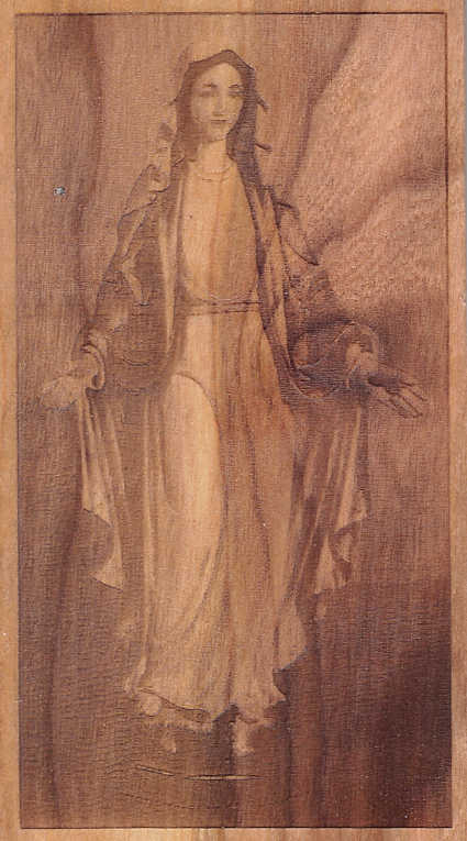

Hi bob
ok you never get a real 3D just a sub 3d more like a relief. I do it all the time with some ikone's for churches see picture.
if you got a good picture convert it to greyscale save it with 638dpi then import it in lasercad, dithere it with about 0.015- 0.018
set the scan gap to 0.04 and the speed to around 160mm/s, the power to about 10%.depending on the wood you are using. the wood in the picture is cherry wood.
maybe this helps

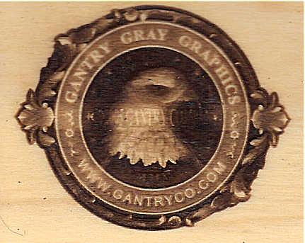

Thanks waltfl, but I was looking for the ability to carve like these: http://gantryco.com/motifs-3d-laser-gra ... phics.html
Bob

hi bob
just look at the picture what they are using they are heavily prepared not like mine where I take a regular 600dpi picture
if I could take one of this picture I would have the same result.

You can send them an email and they'll send you a sample file. I got one. Send me your email address via private message and I'll email the sample file to you.

Hi here is a short run picture of this usually I do two or three runs. this all depends how the picture is prepared.
A good system what I use is to convert to grey then adjust contrast that the picture looks like a bit washed out then unsharpen
save as BMP with 638dpi then import in lasercad there I dithere with 0.015 and the scan gap with 0.04. the first run at around 150 mm speed and 11% power and the second run with 10.5% power same speed
