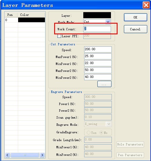

It is a 'huge' request! I asked the programmer before and he said that he had no plan to do it as it involved tremendous time investment to add that feature. If he will, he will do it on my software in the near future per our agreement.
By the way, a new feature will be added to the LaserCad soon. What is the new feature is to allow one to set the number times of cutting or engraving per layer instead of just one for the current version . Before, if you want to cut 1/2" pine wood and need two pass to do it, you have to run the cutting twice manually. But with the new feature added, it will allow you to set the number of pass at will. That's something I can do it for now.
I can't promise the 3D or gray scale engraving but I can promise you that I'll keep "knocking" the programmer door to push him to take some effort

Re: Feature Request: 3D engraving
Got my latest request of LaserCad with 'work count per layer' :mrgreen:
