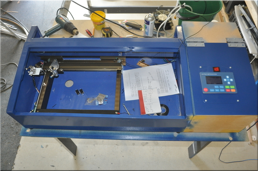

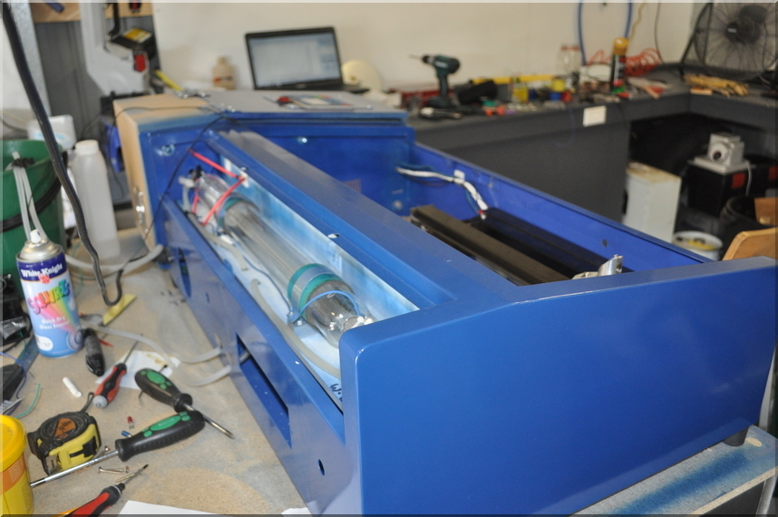

Hi All.
Well Ive had my Moshi box for a couple of months and it was time to upgrade to DSP.
I bought all the parts a couple of weeks ago,
1 2012 DSP Controller
2 1-Axis CNC/ Laser Machine Stepping Motor Driver (TB6560) ,
1 DC 24V 15A Switching Power Supply. Good for CNC Stepping Motor Drive
1 40W PWM CO2 Laser Power Supply 220 volt.
I decided to gut the entire box and remove the divider between the electrics and the laser compartment, and make a new box on the right side to house
all of the new electrics.
I did this as I will also be making a new x/y assembly, big enough to house the extra space.
Still have to finish off the painting of the box.

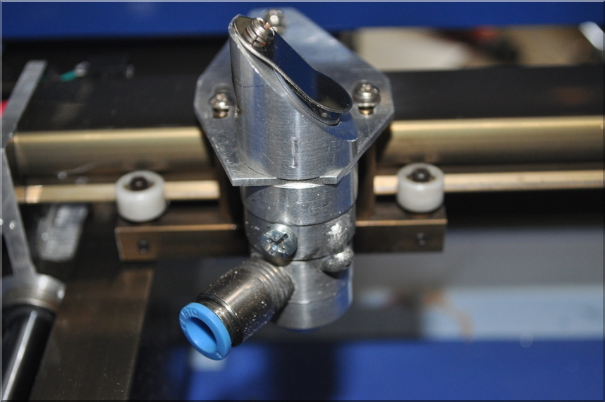

Next picture shows the Air Assist head I made on the Lathe...Works perfectly with no leaks.

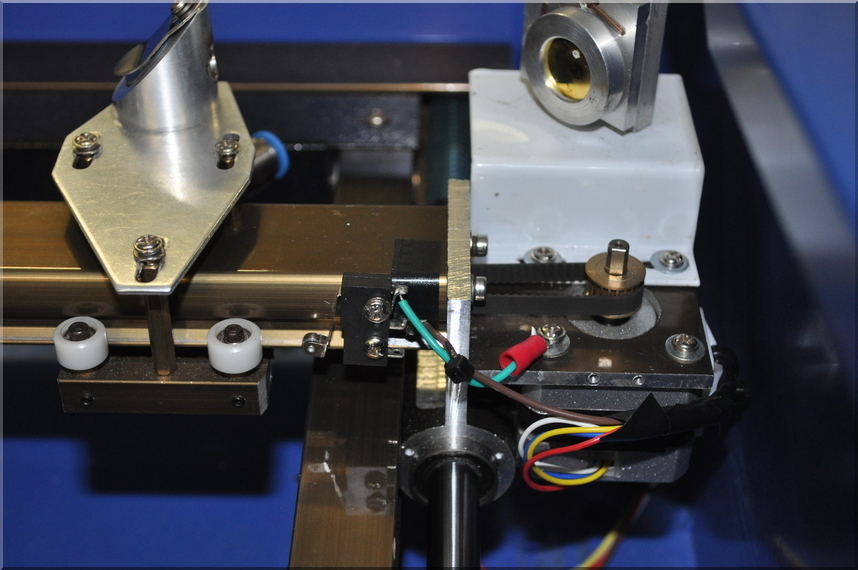

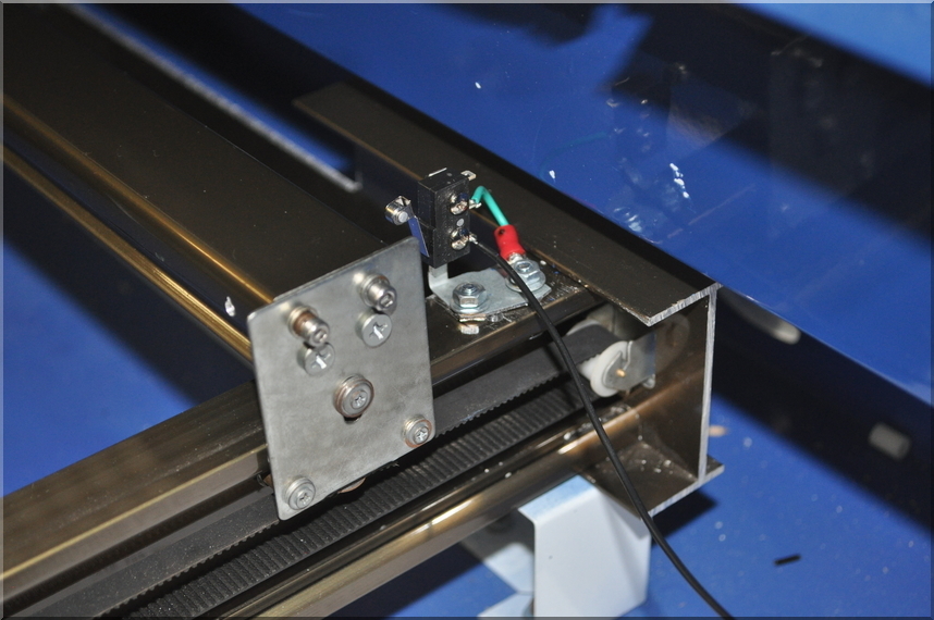

Also the 2 Limit Switches fitted.
And rear of machine Laser Tube.

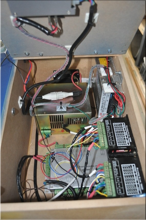

This is were I put all the Electrics including a Fan at the rear to draw out any heat.
