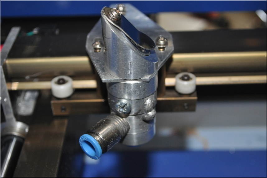

Next picture shows the Air Assist head I made on the Lathe...Works perfectly with no leaks. :)
Also the 2 Limit Switches fitted. :?
And rear of machine Laser Tube.

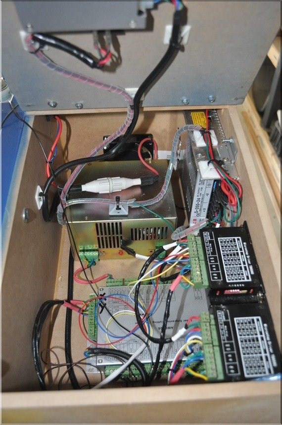

This is were I put all the Electrics including a Fan at the rear to draw out any heat.

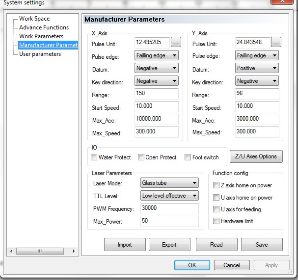

did you make the manufacturer settings in the system settings similar to mine? attached
the range settings should not be bigger then 250 for X and 180 for Y

What are the part number on your steppers? I run my X Stepper at 0.8A I don't have any heat issues. Also be aware that manufacturer parameters are stored on the DSP NOT in the software. You have to click read on the manufacturer parameters screen to see what your DSP is really using and click save after making changes to send those changes back down to the DSP. The same is true for the user parameters screen as well.

Ok. That explains why you are running 2000 Steps per inch in one axis and 1000 steps per inch in the other.
