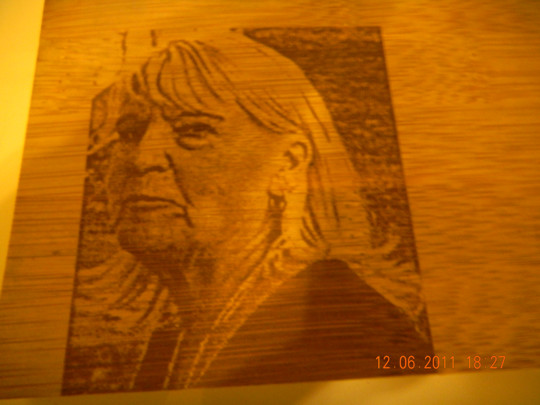

the latest victory was today that I finally was aible to engrave a picture hurrey.
see the pictuire and my engraving setting
