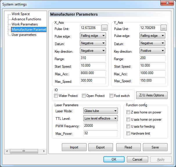

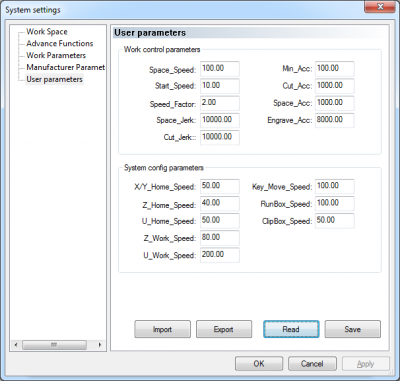

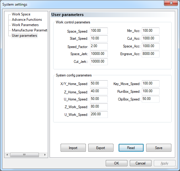

Sorry I was referring to Position Relative. Make sure it is set how you expect it to be, and then download the job again. Attached are my screenshots of the settings I'm using, and yes as you can see from my thread I've also converted a K40 machine. I noticed you have hardware limit checked on your machine do you have 4 limit switches or just those for the home position?

Uncheck hardware limit in the manufacturer parameters, I believe that is used when you have limit switches on both sides of the travel. Just set your bed size in the X/Y parameters on the same size.

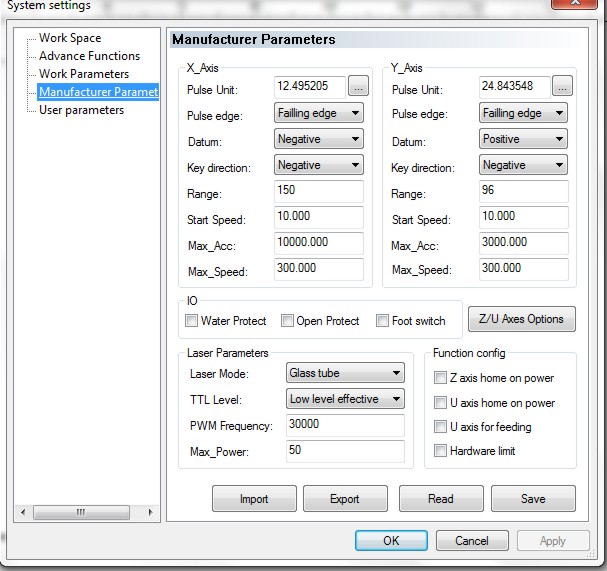

ok after all the bit confusing back and forth now I got it figuired out
here are the manufacturer settings what work perfect for me
what I discovered is that everytime I amke a change in the settings I have to close the programm
and then open it again this is the only way the settings stay

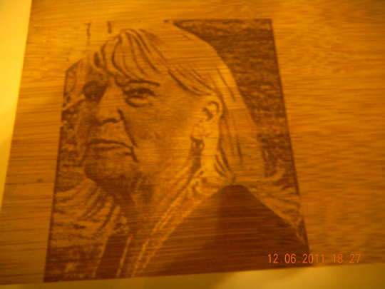

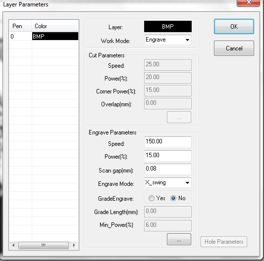

the latest victory was today that I finally was aible to engrave a picture hurrey.
see the pictuire and my engraving setting

The manufacturer and user parameters are stored in the DSP and not the software. Every time you open those pages hit READ to read the current settings from the DSP. Also once you make changes you have to press the WRITE button to send the new values to the machine. Also keep in mind that changes on the manufacturer parama will possibly change values on the user parama page.

you must talk about a different DSP because the lasercut 5.5b from lightobject has not " write " botton only download and if you hit read and you had a different setting on the display from last work it changes to this settigs buit not what you want if you start a new page

Sorry it's labeled as save as seen in the screen shots above. I have the same 2012 dsp as you. The values you get after clicking read are thereal values your machine is using.
