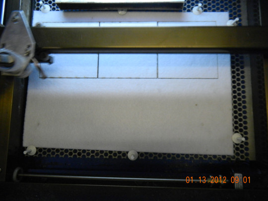

here are a trick how to fasten thin material to the tabel.

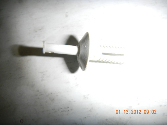

I used the kind of fastner what HD selles to fasten the white fiberglass wall panels
see picture.
thats the rivet sold as fastner at the HD
thats thin selfadhesive felt
