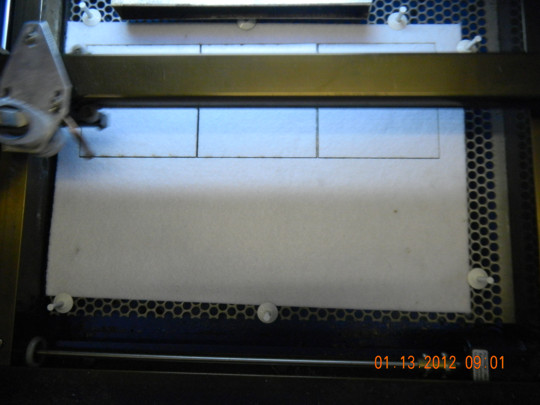

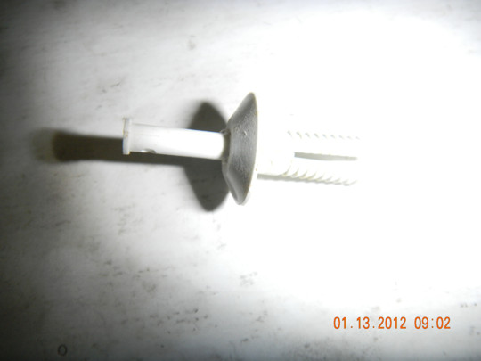

Re: Tips and Tricks
here are a trick how to fasten thin material to the tabel.
I used the kind of fastner what HD selles to fasten the white fiberglass wall panels
see picture.
see picture.
