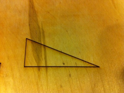

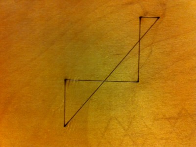

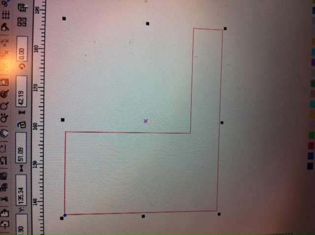

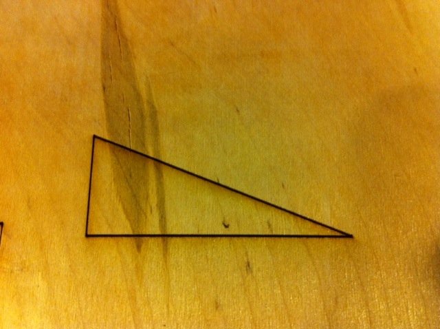

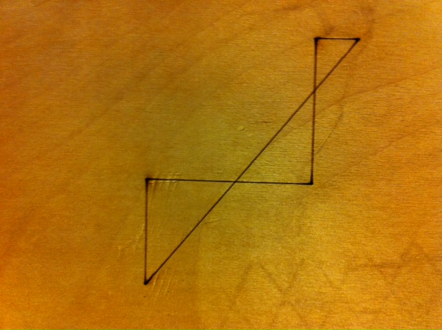

I am having issues cutting the attached shape out (The shape is an L shape.)
The laser does the first part correctly, and then just skips a point, creating a weird triangle shape.
The attached is a LaserCut 5 saved file.

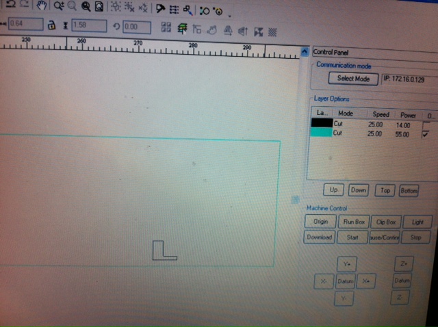

Here are some photos of the issue happening.
The one is an L shape. The other is a rectangle that I was trying to cut out. Notice it has the L shape in there, but it is disabled. Just the fact that it is in there, breaks the rectangle. If I remove the L, the rectangle cuts correctly. Thanks.
