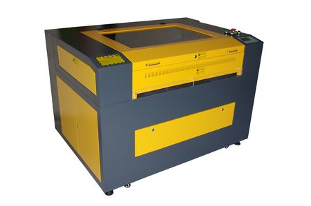

thanks for the reply, the machine is 3 years old and replaced the linear bearings and rails as they were worn out.
It is a 600 x 900mm cutting area machine, will take some pictures of it tomorrow.
Was originally a 60wt tube fitted to it, but have replaced it with a rici 80wt tube now.
Here are the specks on it, and a stock photo.
Product model JD4060 JD6090 JD90120

Cheers
Pete
