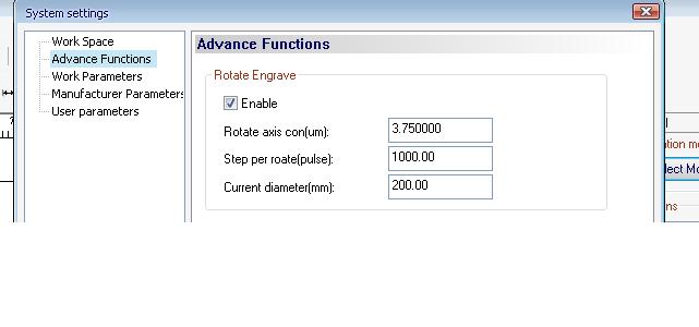

Why then exposed these options?
- параметры.JPG (22.19 KiB) Viewed 2249 times

Re: How to engrave on the 4-axis?
Correct! You need the Y-signals for the rotary-unit. The settings on the "Advanced Functions" apply to the rotary when you use it instead of the Y-axis..
