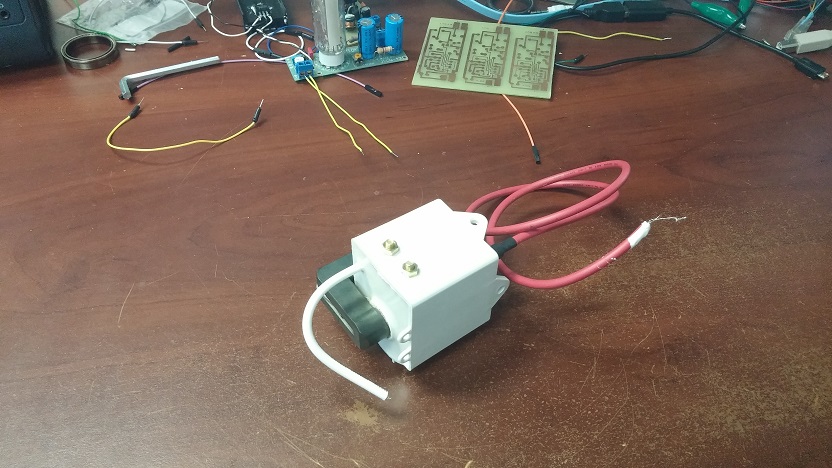

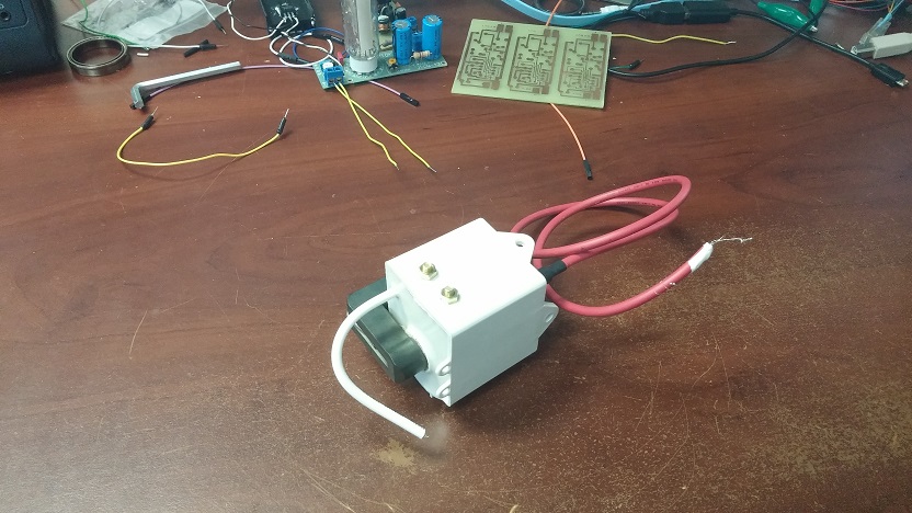

So I pulled the Flyback and checked the primary windings.
I found 0.6Ω on them but the secondary appears open.

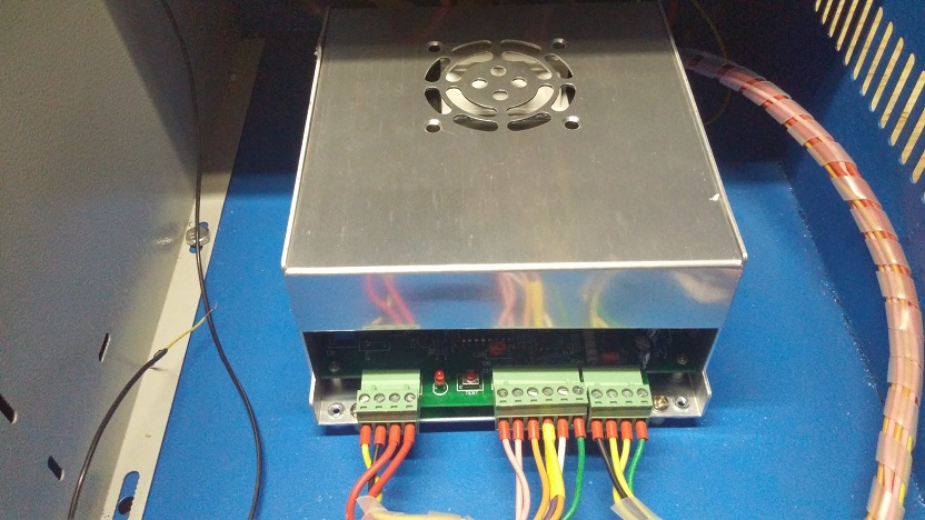

Please post the image of the LPSU and the transformer. I may be able to get you a replacement.. But it is $25+ S/H . I can't do it $12

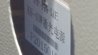

Here are some photos,
It just occurred to me that I may or may not have installed the top cover backwards. so the fan opening, for which there is no fan... may belong the other way around...
oh, and this is a 110v model
Thanks!
