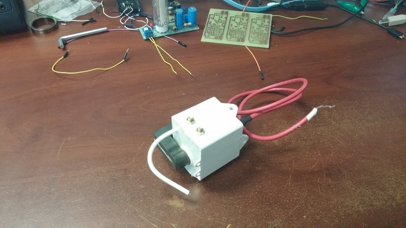

So I pulled the Flyback and checked the primary windings.
I found 0.6Ω on them but the secondary appears open.
I will test it again tonight with a fluorescent ballast to see if I can get it to fire.
My question is this: I'm looking for a US based source for the replacement transformer only. Not an entire PSU assembly.
I'd like to repair this unit if I can because it seems more sensible to replace a $12 transformer than buy a new PSU for $100+ or pay Alibaba $20 to ship one out which will take another 30 days or so..

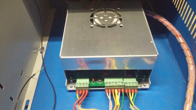

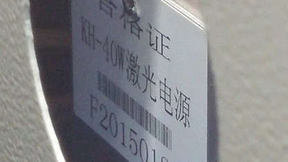

Please post the image of the LPSU and the transformer. I may be able to get you a replacement.. But it is $25+ S/H . I can't do it $12

Here are some photos,
It just occurred to me that I may or may not have installed the top cover backwards. so the fan opening, for which there is no fan... may belong the other way around...
oh, and this is a 110v model
Thanks!

Ahh.. Never mind the transformer. I'll just get a new lpsu.
Which one is recommended for easy install?
