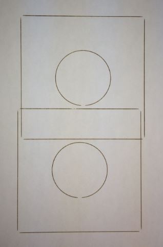

I have finally completed my upgrade and mirror alignment and after following the instructions to resize the "UM" settings, the 100mm X 100mm box drawn using Laser Cad is truely to scale.
However, after numerous attempts to change settings ... includeing the changing the corner settings from Falling to Rising and then back again to Falling, all four corners of the box are not being bunred.
I also drew a 45mm diameter circle inside of the box and the circle is also not complete at its start/stop the 3 O'Clock position, it looks like the letter "C" with a small opening of approx 6-8mm.

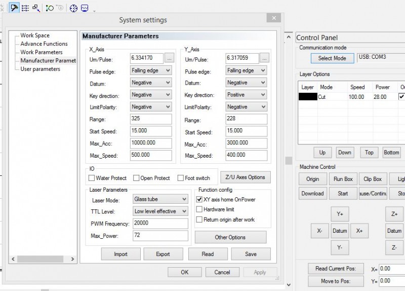

I have made two additional trial runs and increased the power level first to 25% and the second attempt to 28%.
My laser tube is 35 Watts and the Amp Meter was registering 3.9ma and 4.7ma respectively.
Unfortunately, the results of both runs have left the corners not cut and the paper is cut through instead of being scorched.
Any additional
I have attached a pic of the run and a screen capture of the Manufacturer Parameters below.
Jason

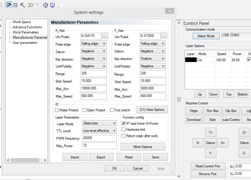

Hello and Thank You for the reply!
Any additional
Jason
Re: Post Upgrade First Moves and Burn
Definitely you did not set up the min power (corning power) properly.
There are two power setup for cutting: max power and corning
The corning power is better set at 70% of the max power. Note, this need to be done on layer level.
