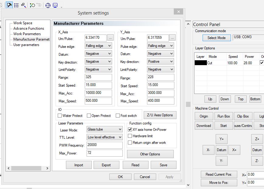

I have attached a pic of the run and a screen capture of the Manufacturer Parameters below.

Re: Post Upgrade First Moves and Burn
Definitely you did not set up the min power (corning power) properly.
There are two power setup for cutting: max power and corning
The corning power is better set at 70% of the max power. Note, this need to be done on layer level.

Post by Baffled »
Hello!
I had changed the Minimum Power Setting as you suggested and it worked perfectly ... Both Squares and Holes are complete!
