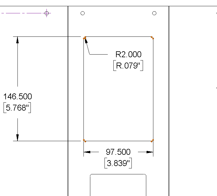

Can anyone tell me the size of the back of the X7 controller? I would like to start on my Installation panel.....

mikenmel08 wrote:Can anyone tell me the size of the back of the X7 controller? I would like to start on my Installation panel.....
Mike
Dear Marco,
I'd like to know the dimensions too please, I'd rather start making the panel for the machines I'm building now and not wait until the DSPs arrive.
Thank you
MitchL
Posts: 71
Joined: Fri Aug 23, 2013 4:40 pm
Location: California
Re: X7 DSP upgrade kit for D/K40
Post by MitchL »
Here are the dimensions I used for my AWC708 panel. It was a little tight (the 708C wants to "clip" in) but it worked.
I installed mine in 22ga steel.
Interesting note: this opening is also well sized for an AWC608 if you use my 3D printed bezel (model is in the forum here somewhere).
/Mitch.
The opening shown here is rotated 90 degrees, it was taken from the drawing of one of my machine's skins.
AWC708 opening
AWC708 opening

MitchL wrote:Here are the dimensions I used for my AWC708 panel. It was a little tight (the 708C wants to "clip" in) but it worked.
/Mitch.
Thank you very much!
Fernando

Hi Mitch,
If it's not too much trouble, could you please help me with a drawing of the outline of the X7 DSP together with the hole in the panel?, I'm making some decals and labels and that helps me position the components on the panel correctly.
