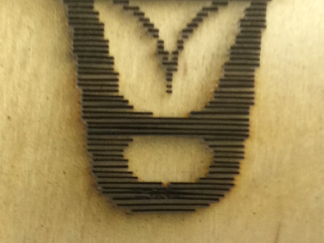

I have been trying to engrave an image. it was fairly low les and I stretched it out but when engraved it was scanned like this. each line is lased several times. Why is it doing this and can I change the over burn.

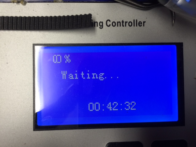

while doing this engraving this started showing after about an hour.
each line is lased several limes before moving to the next.

I have the same issue. It runs a couple passes over the same spot then jumps, runs a couple passes over the same spot, etc.
Cutting seems to be on size and repeatable, but any engraving I do gives these results.

well it seems you have to turn off BMP optimize in the engrave settings, seems to work for me now.
