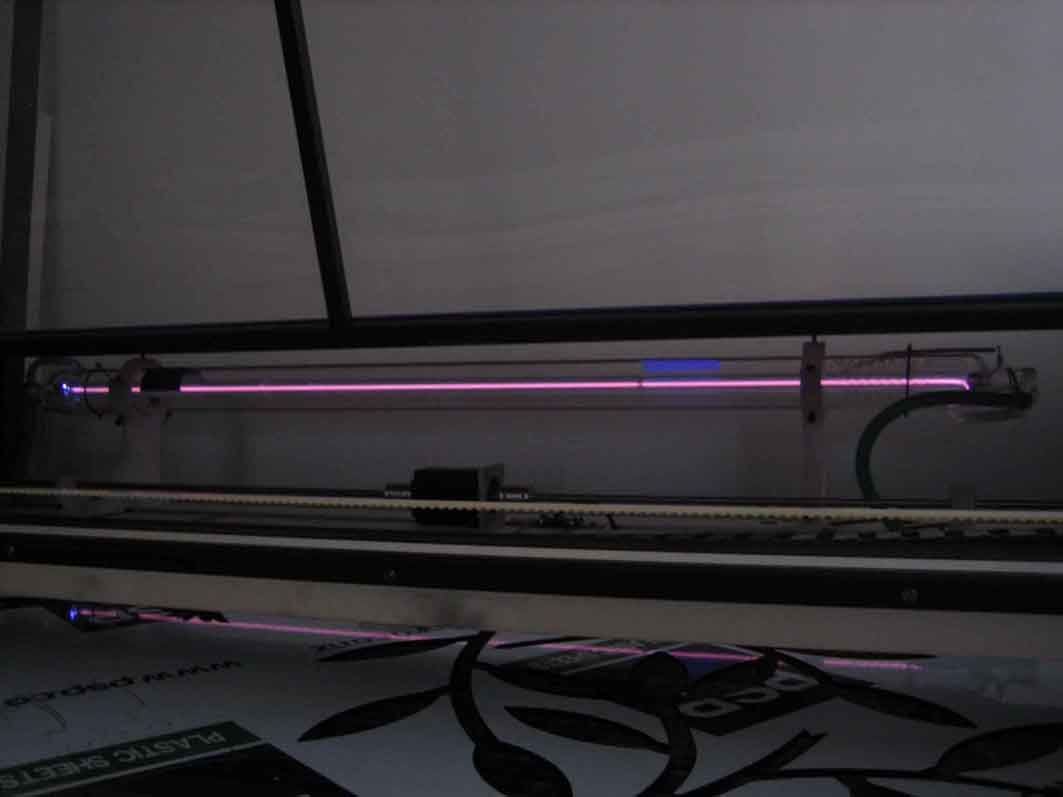

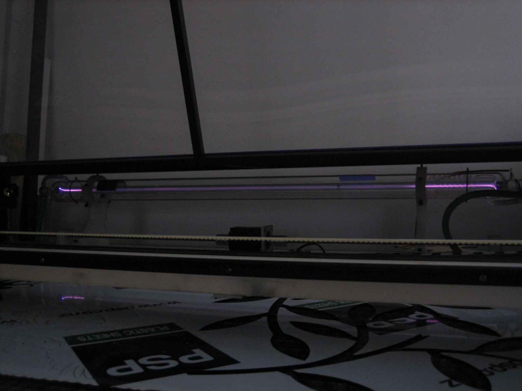

Just returned from holiday and went to use the laser cutter and its not cutting.
The lasers bright purple when firing and the I've tried upto 18ma power and still no good. Checked all wiring etc and all is good.
Does this mean the tubes gone(its only 2.5 months old) ???.

If it is lightning in "bright purple", more bright and purple than usual, it means that the tube is leaking and the tube is dying. Better to show some images. How did you connect it? And what power is the tube? Where did you buy the tube?

I have attached 2 pictures.
Picture A was running the tube at 50% power and the power meter read 6ma
Picture B was running the tube at 90% power and the power meter read 15ma
Neither would cut through 3mm acrylic.

So do you think its the tube looking at the uploaded pictures/info?

Hi marco,
After some more testing it looks more and more like the laser tube has gone bad.
