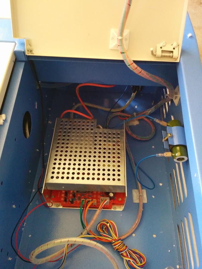

Ok Laser came, heres the power supply. Im guessing by the big green resistor its not PWM. What else can I look for?

This is not a pwm power supply
