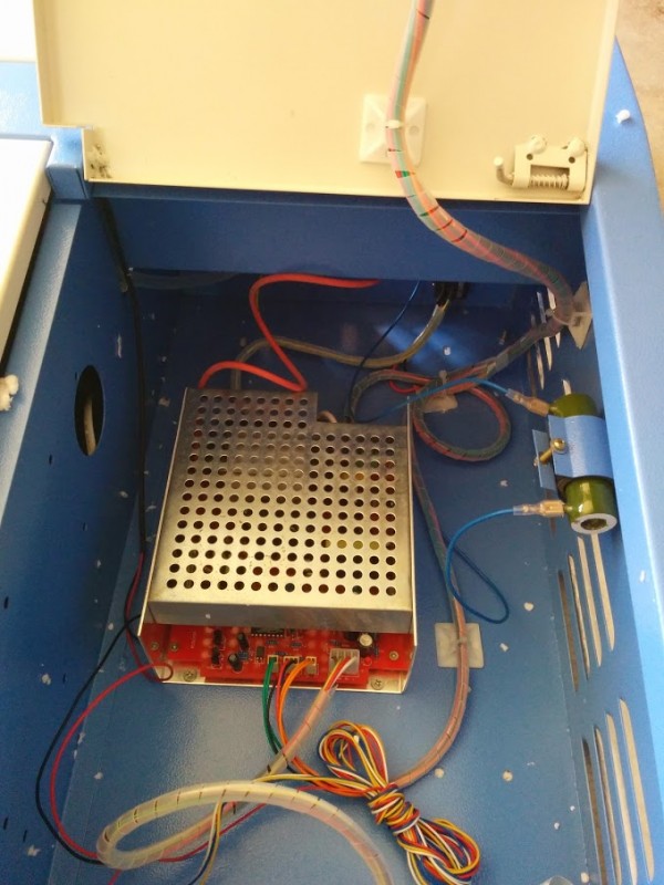

Ok Laser came, heres the power supply. Im guessing by the big green resistor its not PWM. What else can I look for?
Re: How to tell if my machine has a PWM power supply.
This is not a pwm power supply
. Marco
. Marco

cool thats what I figured. Ill get my order in today!.
