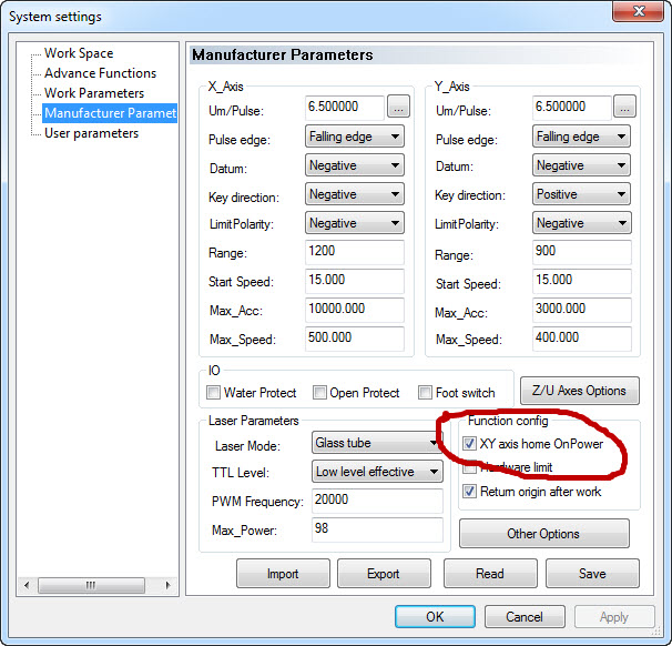

you need to set this in manufacturer settings but first read then change then save.

Done all that waltfl. Read my post above.waltfl wrote:hi there
Nothing wrong with my home switches.
"Read then change then save" till I am blue in the face. "X Y Axis home on power" setting will not "Stick" Reverts to "Checked"

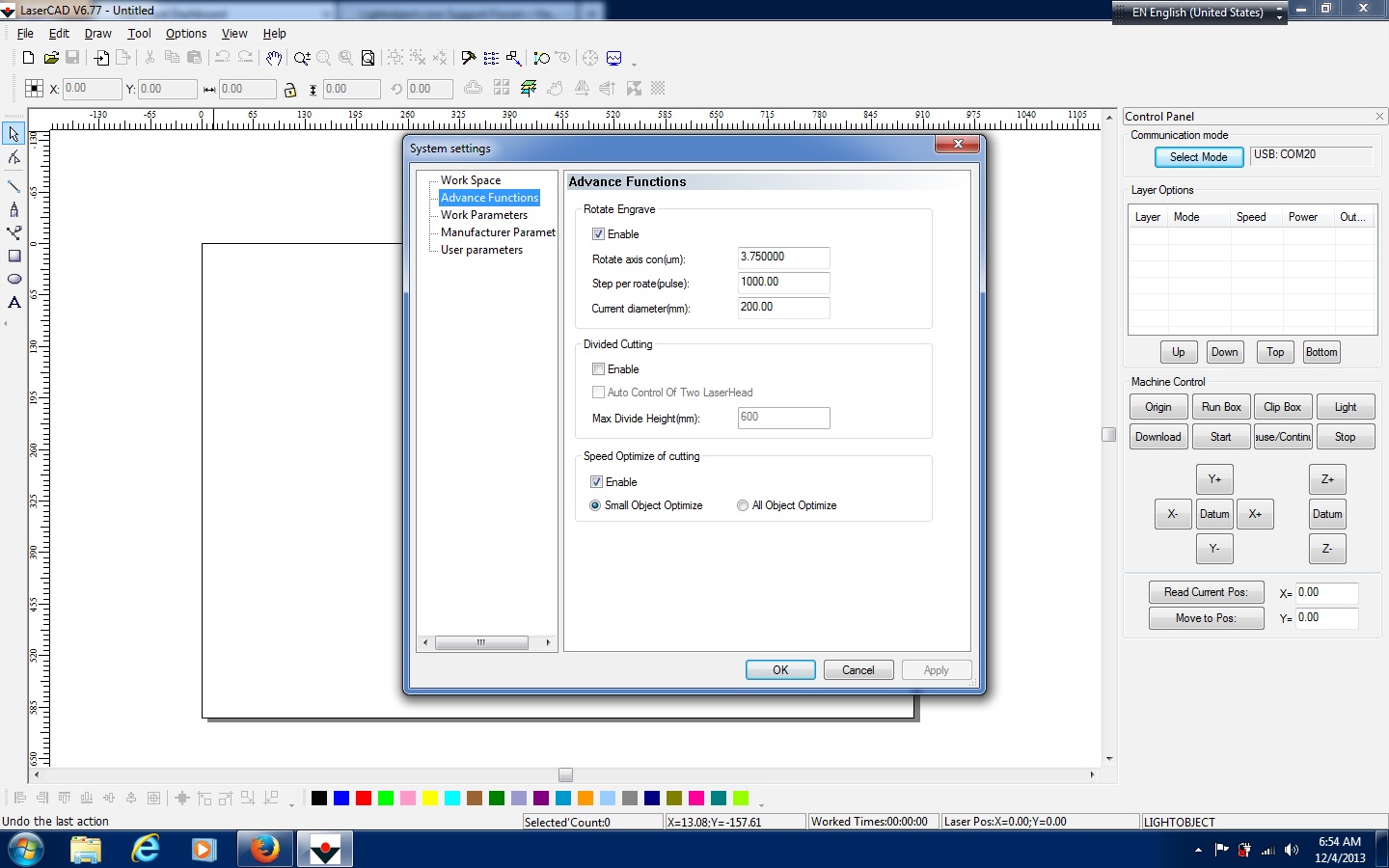

Try enable the "Rotate Engrave" feature
It will disable "Y" limit and it is totally in-dependable to the Y paramters

Tried that a number of times. It does not disable Y axis homing on startup.
Also I do not use that part of the software because it mostly does not work.
It only works for engraving. It does not work for "cut" or what I call vector engraving. It does not work for "Run Box"

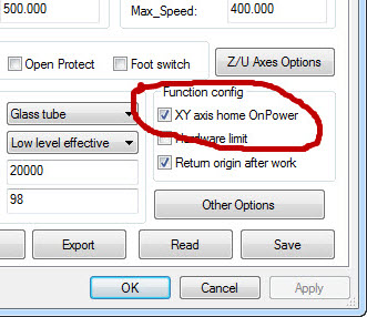

Read, uncheck the box, save the change, and read again. It has defaulted back to checked or selected.
Either I am doing something stupid or it needs programmer attention.

- XY axis home on power.jpg (133.51 KiB) Viewed 4574 times
