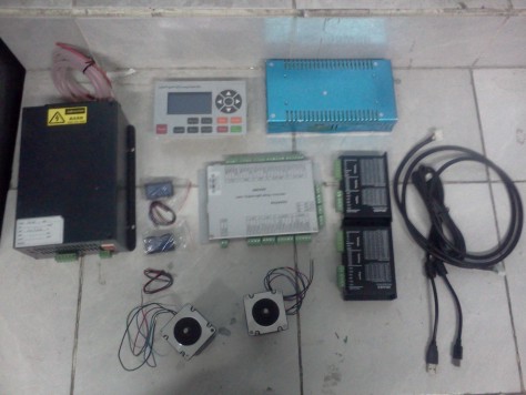

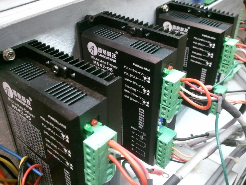

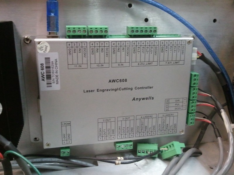

The parts have arrived past thursday and I'm ready to go! After thorrough research and documentation I'm wiring and prepping this frankenstein of a laser machine for a few trial runs.
- parts.jpg (36.11 KiB) Viewed 7710 times

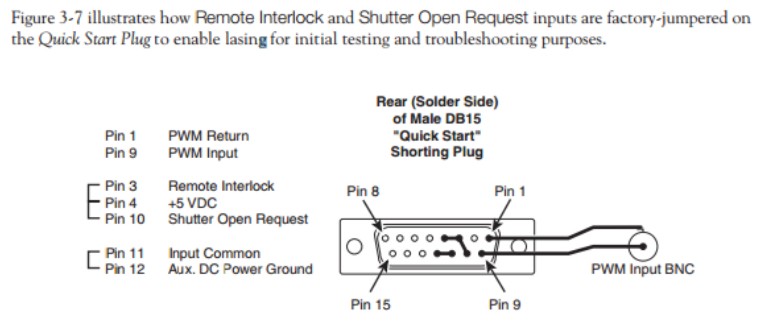

Ok movement is working OK, and according to this image I should be able to jumper the Synrad Firestar to work on a continuous wave so it would be receiving PWM signals from the AWC608 without having to wait for the shutter or the safety signals.
- factory jumpered.jpg (42.46 KiB) Viewed 7701 times
Hermes
- Posts: 46
- Joined: Wed Sep 11, 2013 9:31 am
IT IS DONE!
The machine is working OK with the jumpers configured as depicted in the previous reply, it's even faster than before and with a little tweaking, I can get it to work quite better than it originally was.

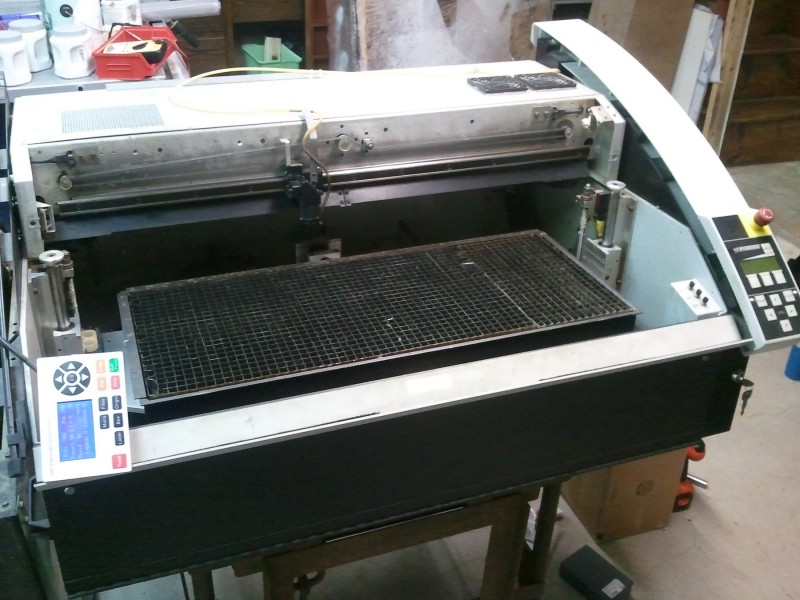

I'll be sending pictures soon once I clean up and organize the wiring and all the parts are firmly placed. Right now they're just sitting loose on the gravograph's chasis.

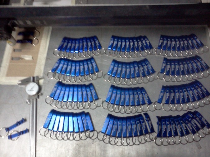

My Gravograph LS600 is working like a charm, I've already got it loaded with lots of engravings to make. First up, 4k keyrings/bottleopeners, half blue half red, all anodized aluminum, at 0.10$ each after costs, the DSP just payed for itself in a couple of days.
Will start working on my 2nd machine.

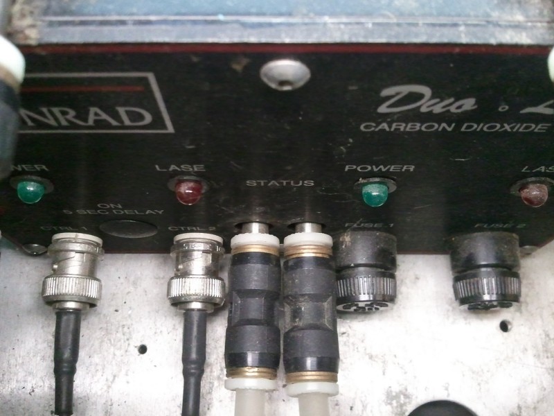

I too would like to see your machine. I have a Synrad Duo Lase 100w laser that I am looking to fire up. It has two inputs which must be similar to what your diagram shows, but internal as this was how it was controlled using the old computer control system.

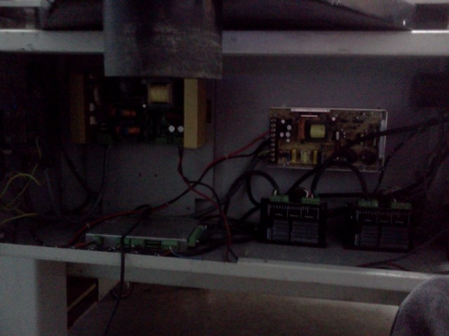

Well I kept the solid state relays originally with the Gravograph LS600, each one of them to one PSU (lasertube and DSP)
http://www.alldatasheet.es/datasheet-pd ... 42910.html
I decided to keep the laser tube's original PSU, since it's working fine, and I haven't found a way for the PSU from lightobject to work with the synrad's internal RF driver.
I had to keep the back open and the PSU's exposed in order to ventilate, since the DSP's PSU didn't provide the 12vdc for the fan that came included in the casing. I'm guessing it's just defective, I had it tested and there's no voltage on the leads to which the fan connects.
The laser tube also has a 12vdc fan but I had to prescind of it, since I don't have a 12vdc power source, I got one in back order but in the mean time I'm cooling it off with a stand fan, it's working fine, I check the temp often. The Synrad tube has a temp security override that will shut it down in case it gets too hot.
Once the 12vdc PSU arrives I'll connect both fans and the machine will be finished! (still planning to do that with the extra Synrad firestar v40 I got lying around here)
Hermes Sandoval.

The connector is pretty much the same to the v40, they're firestar after all. You'll need to make the same adaptations I did, according to the DSP's wiring diagram provided by Marko Wong. I kept the original power supply, if you have yours around it could help. The signal goes directly from the DSP to the laser tube's RF input connector, its DB15 interface. It was also internal, but removing the fan leaves them exposed, at least on both my Firestar v40s. There's a diagram on the manual on how to jumper the pins to work with the DSP awc-608, it's the same procedure for the firestar f100, I posted it above.
