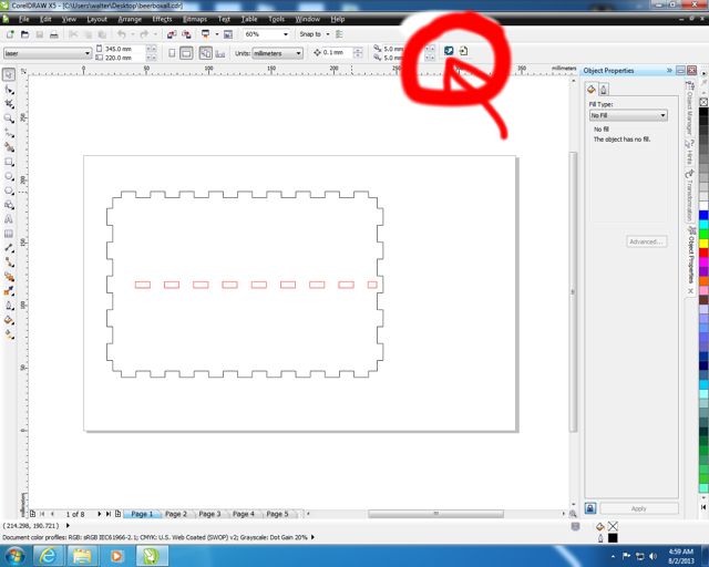

Re: Cannot find the Corel direct output file AWCLaserCut.AW
Hi there
here comes picture from the setting for macro
first open a new CorelDraw file, then follow the picture after them then close the file and then open a new file again and you will see a little icon mostly blue drag it to the top line box ( see picture) and you are all set.
now if you open your file then just click on this icon and the file will be transferred to the lasercut program,
