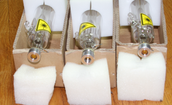

I recently bought http://www.lightobject.com/45W-CO2-Seal ... -P751.aspx 45W
Co2 tube from lightobject :) .
I find a difference in the aluminum laser head between the supposedly
same tubes :? .
The product is supposed to have manufactured by "Bill Laser Products",
with the model number being 1000.

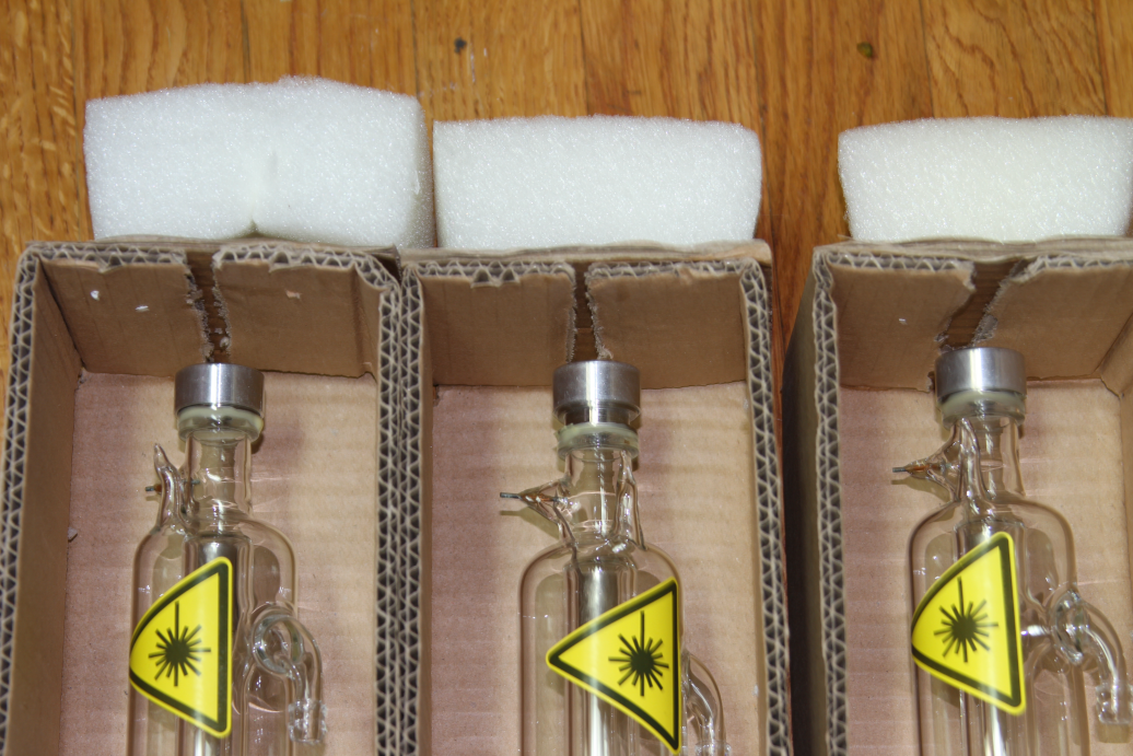

Only one tube has an extension of the aluminum head(as shown in the
picture), while the other(s) does not have this(could post a pic. if needed ;) ).
Not sure if this could affect the tube life in future(esp. the short aluminum laser head,
the one without the neck/grooved portion). The extra grooved portion adds about 5mm
to the total legth of the tube. The tube is supposed to handle upto 50W at 100% power.
Would sincerely appreciate if anyone from tech support/other members could shed
some light :idea: , to take appropriate steps to prevent a premature failure(such as
keeping a close eye on the tube operating temperature/current etc.). I am also
not sure, if I need to contact lightobject for exchange due to the same reasons.
I would also note that the serial number on the long neck aluminum head
tube is later than the other(s).
Thanks/Best Regards
Raman Narayan
Re: Help!Same model Co2 tube has different aluminum laser he
Hello Raman
All those tubes are from the Bill. The aluminum head has nothing to do with the life span. No need to be panic. It's very standard tube. We will stop using BIll's tube but using another supplier in the near future.

Thanks for the positive affirmation. Could you send me PM, if there was
any issues in the past, or why you will stop using Bills Products?(I am just
interested in taking care of the tube properly-right cooling/current etc).
I am also posting the pics. if that is of any help in showing the differences.
Thanks/Regards
Raman Narayan
The Bills laser is OK for 60W and 80W. I heard that their 100W was not very stable so I stop carrying their 100W even though they launched a 100W tuble "looks" like the Reci. Plus their price wasn't cheap.
The other reason I stop importing their tubes because I don't like the way they handle their tubes. The 40W ~ 80W are pretty stable but I don't like the way to pack it, and the way the supplier dealing with me when problem exists. First of all, I hate to see 'finger print' or powerder (or dust) all round the tube after testing. I'm selling tubes for as low as $200 to as high as $2000, it's not a cheap item and I want my customer happy to receive a clean and nice tube but not 'dirty'. Plus, very odd that some tube has a mark done by melting. I asked the supplier why it happened and he said that it's just a marking. But I don't think it's a good idea ot put any marking by melt down to the surface. Who know what it could happen on that melt spot. Then, when it came to a problem like a cracked tube, the supplier want me to broke the tube, take the lens/mirror out and mail back to him in order to quality for a replacement. Before I deal with him, he promised that he didn't need me to do so like other supplier request. But, it seems it is not the true. It seems that he has no 'trusty' on me so why would I want to deal with someone who has no trusty on me and on my company. By the way, his price for me isn't very good either. As you said, one of the tube has different setup even though it has no harm and peform the same way. But, it's not good for the same item but not looks the same once a while. You have complained, belive me I did complain it as well.
Now, I got better SP tube for less cost. The SP is very famous for quality. They don't over production and they have better quality control. The SP is located in ShangHai, China. You know, ShangHai has better quality product than other place else. I just found another party selling 700mm and 850mm laser tube in ShangHai. Now I have other 4+4 for preliminary testing. So, no more Bill's laser. They failed to meet my standard on both quality control and customer serivces.
