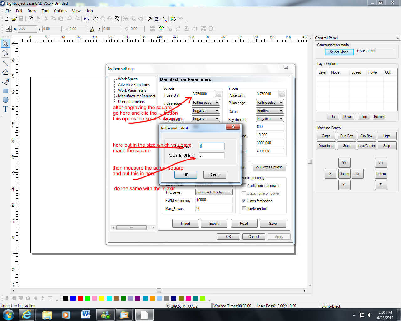

you need after setting the micro steps ( evry time you change the settings dip switches) you need to do this

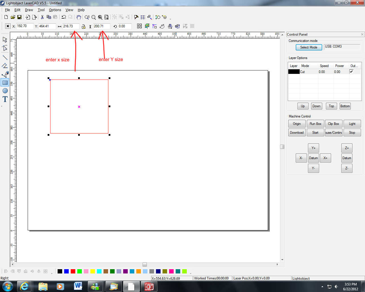

generate a square of 50mm in lasercut then send it to the machine and let it run measure the size the go to manufacturer settings and click the dottet botton on the X and Y line ther open s up another submenue wher are two lines to top one is the measurment what you have generated and the bottom line there you put the number in what you just have measured the same by the Y line.
make another test run and measure again and revise if the measurments not right.

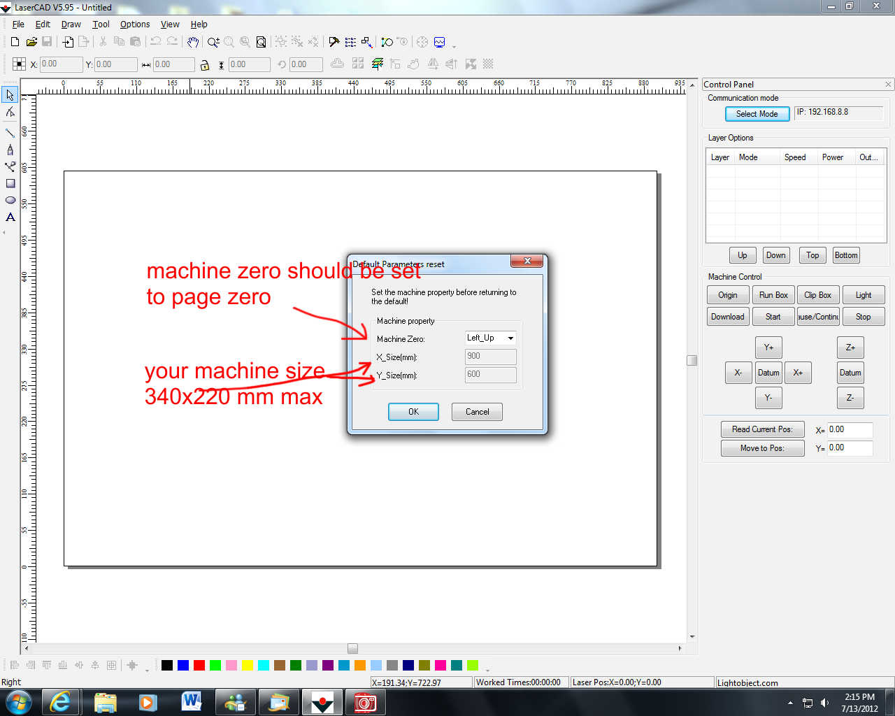

in the manufacurer settings you put the work area of the machine in like 340x 220 the usually K40 size not the work piece.
you also need to put in top left or right as home position.

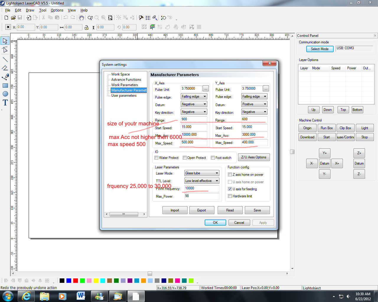

I have attached a few initial settings what I have used with the other people ad give you some sucess.
then go to your display press menue - scroll to lasersettings select software press enter then ESC

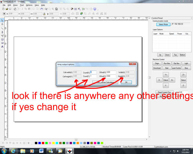

here are two more settings to check see attached picture

Re: Need help with getting setup properly.
Hi tim
I guess oyu need to start over with thinking how.
ok the descriptin from twehr is still valid if you got the same parts. if you woyuld make a few picture of your machine and the interior then we could see what is going on.
yes there is so many descriptions for the same thing with different names this comes that the most who start does not know the right name.
for exaple the " gold box" is mostly tyhe laser power supply but some manufacturer put a blue one in there starts the confusion that why a picture tell 1000 words.
dont worry about how it looks when you take pictures we are not judging just try to help.
for the settings on x and y it starts with the dipswitch settings on the driver"
SW5=on
sw6=off
sw7=on
sw8=on
the settings for the current should be :
sw1=off
dw2on
sw3=on
the dipswitch 4 should be off
see the attached manual this is for all 2m542 driver does not matter what letters are in front
on the connection side :
dir > dir
pull > step
+5V
gnd
the motor
a+to a+
a_to a-
b+ to b+
b-to b-
you need to find the two pairs a+ and a-, and b+ and b-
thats all what you need for the motors
attached are a diagram of all the connection.
