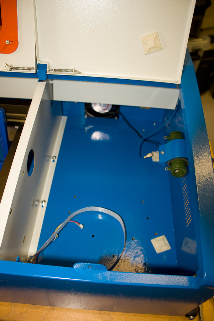

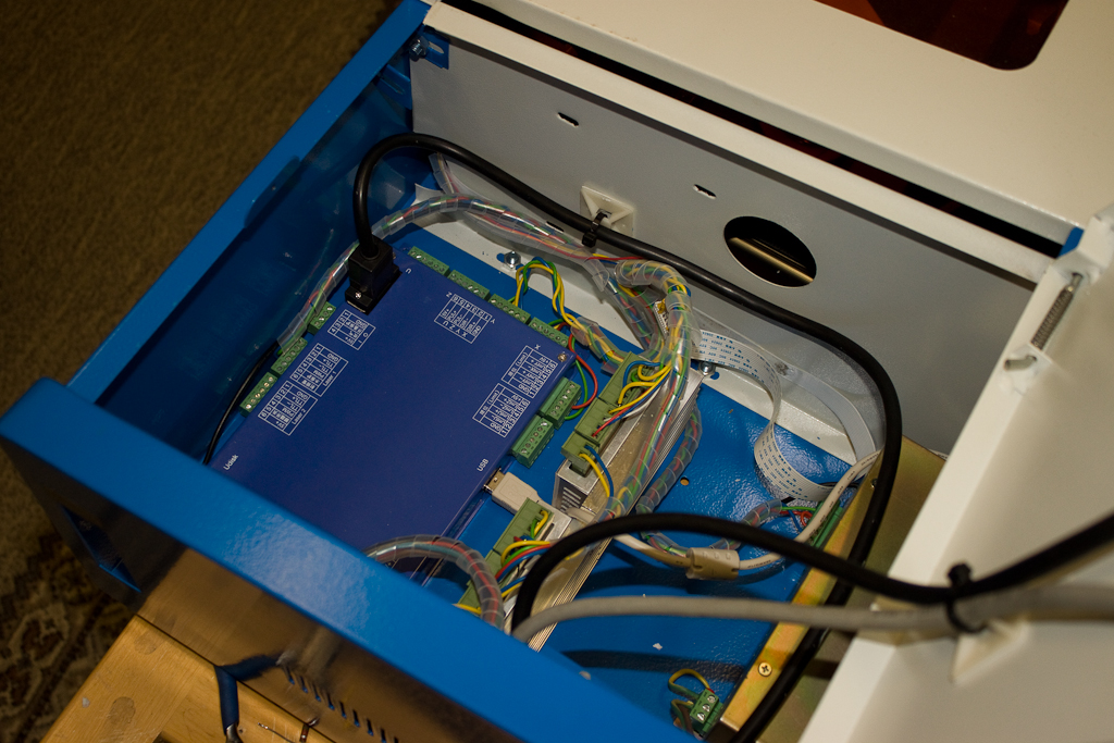

Couple pictures of my conversion... do i have to use that big resistor look picture 1567 right side??? now it's not use but it's working

Re: Converting K40IV machine
anybody know that resistor?TeacDance wrote:Couple pictures of my conversion... do i have to use that big resistor look picture 1567 right side??? now it's not use but it's working
twehr
- Posts: 204
That was part of your original power for the laser tube. Don't need it with standard laser power supplies (like the ones from LightObject and other sources). Take it out and forget it.TeacDance wrote:anybody know that resistor?TeacDance wrote:Couple pictures of my conversion... do i have to use that big resistor look picture 1567 right side??? now it's not use but it's working

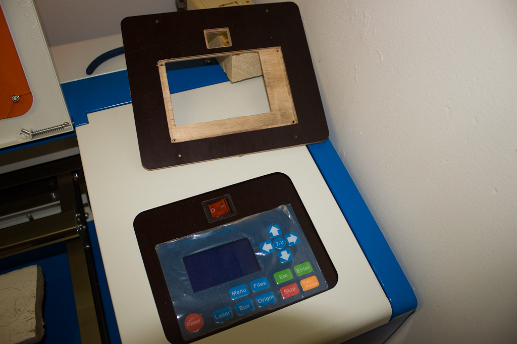

Today i made new control panel holder my wood router here is couple pictures

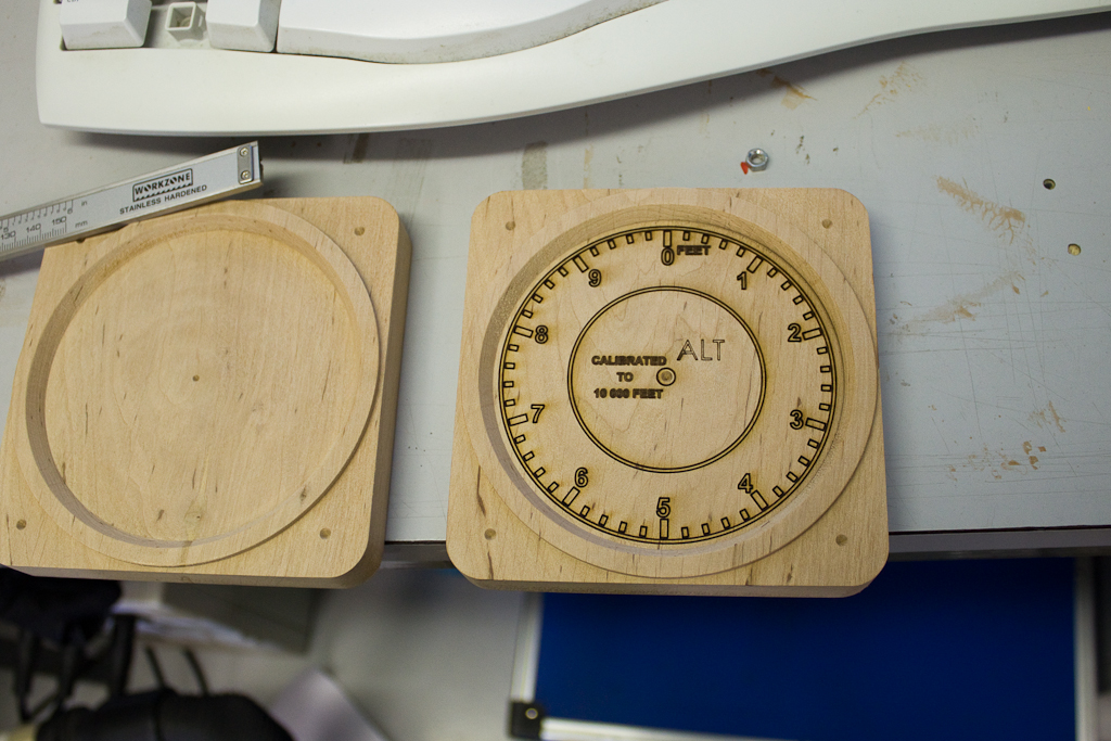

Today i do 30 pcs customer job and earn little cash back
First cut wood router basic instrument base and next burn laser detail. meter use in sauna
