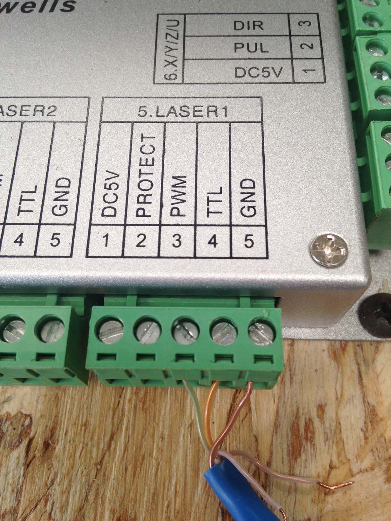

It is pretty simple to connect the DSP card to the PSU. PWM -> IN(PSU), Gnd -> Gnd(PSU), TTL -> TL(PSU)
Look at the AWC608 Interface.pdf file I sent you and it show how the connection is made

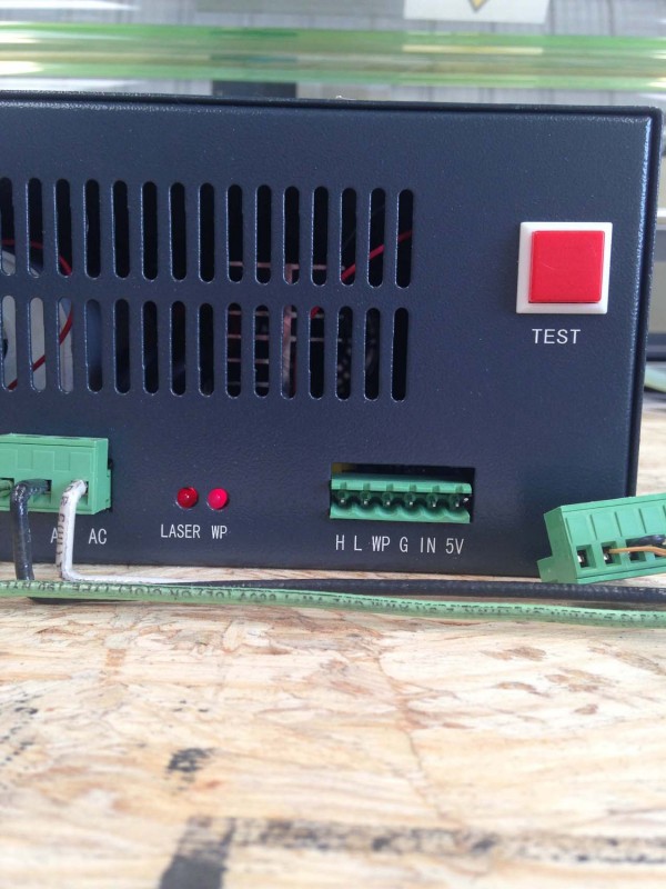

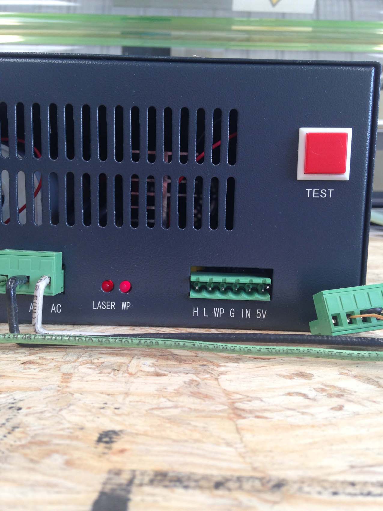

1. Laser PSU without plug from DSP to Laser PSU. I get two red lights (Laser and WP) and laser PSU test button will fire laser

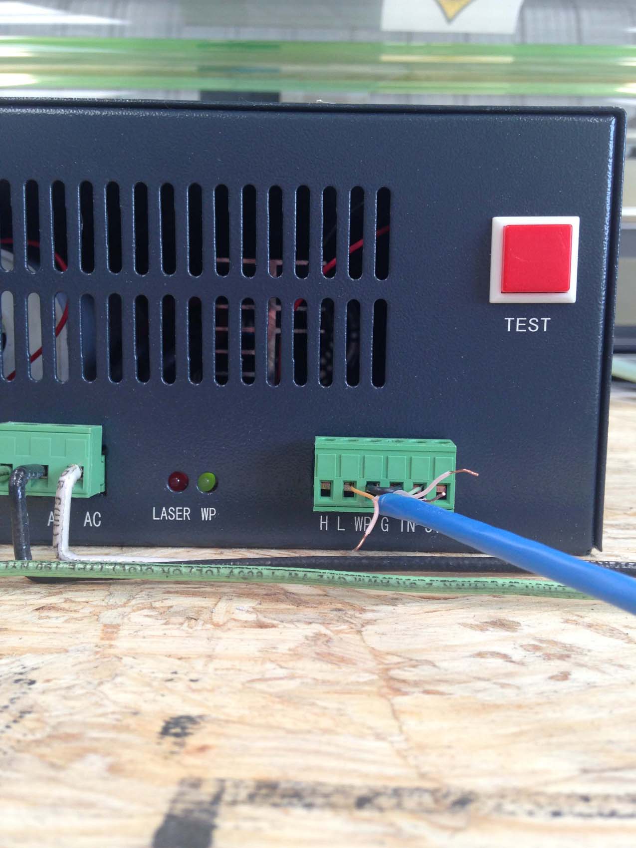

3. with dsp cable plugged in laser light goes out and WP light goes green and does not test fire from power supply or DSP

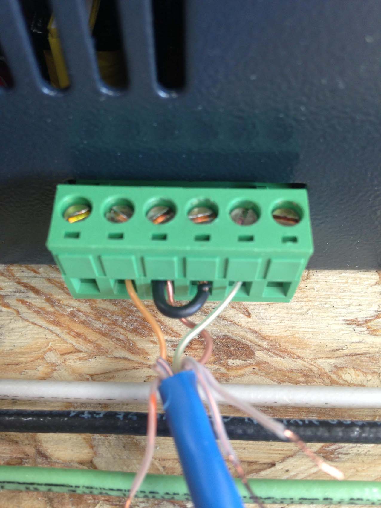

4. DSP wiring
I have tested both ends with meter and the wires are connected good.
Picture number and description of what happens.
4. DSP wiring

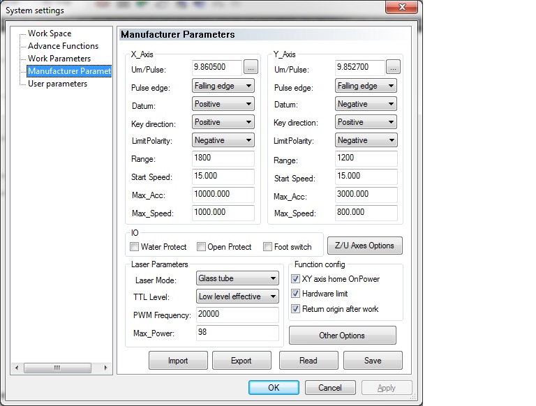

Shoot me screen capture of Laser cad setup. Did you setup power for the drawing?
If it still not work, try Laser2 output

Here is my setup picture. I tried connecting to laser2 and the exact same thing happens.

What abou the power level setup on the work file? Set the power level to 50% and give it a try. Remember that you need to set the output power from the layer setup beside the System max_power setup
You may test the PSU by applyunh +5V to the "In" and ground the "WP". Once you bridge the "TH" to the ground "Gnd" That wat you tell if the PSU is working or not through this preliminary test
If you havea DVM, you can check the output from the PWM see if any voltage appeared on the terminal. When you set 50%, the output should be 2.4v or around. When you set power to 10p%, the voltage should be 4.8~4.9v
Let me know
