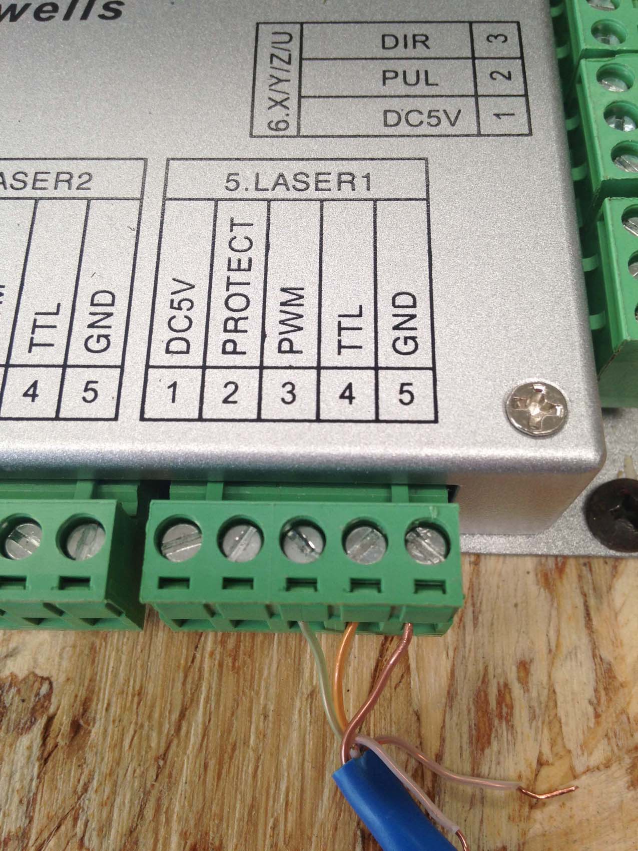

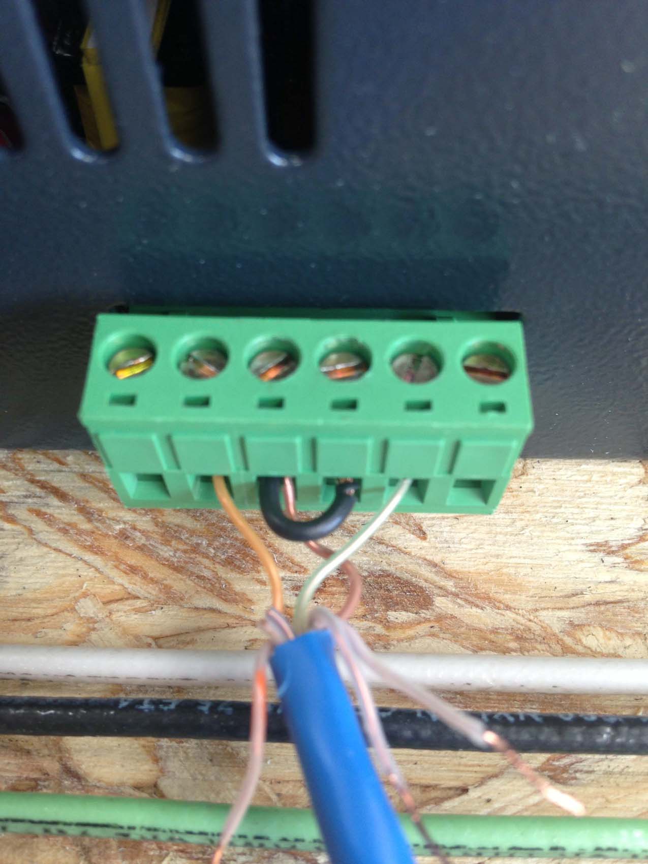

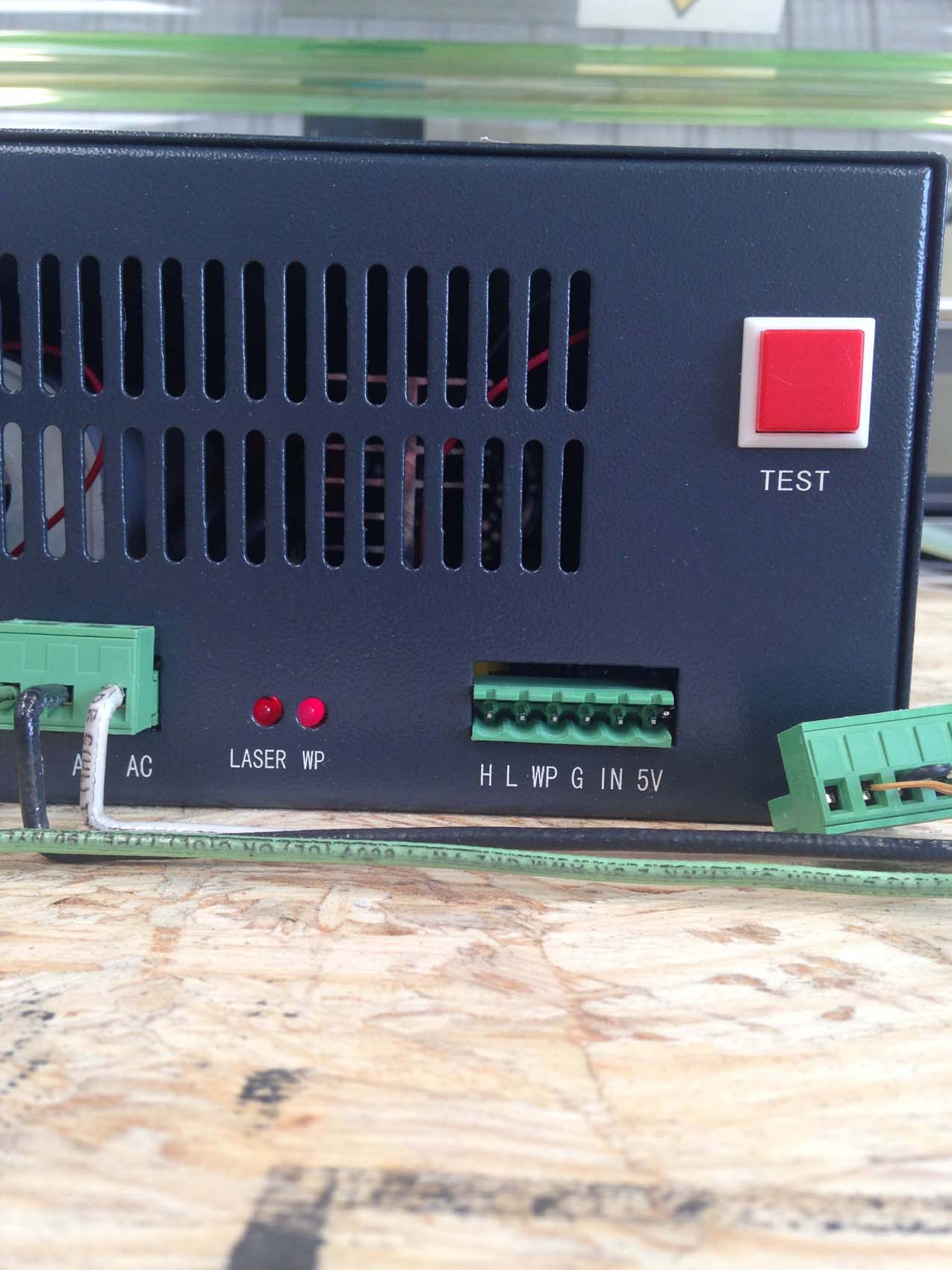

Here are some pictures and problems that I have.
Picture number and description of what happens.
1. Laser PSU without plug from DSP to Laser PSU. I get two red lights (Laser and WP) and laser PSU test button will fire laser
2. with dsp cable plugged in
3. with dsp cable plugged in laser light goes out and WP light goes green and does not test fire from power supply or DSP
4. DSP wiring
I have tested both ends with meter and the wires are connected good.

Re: DSP doesn't fire laser
