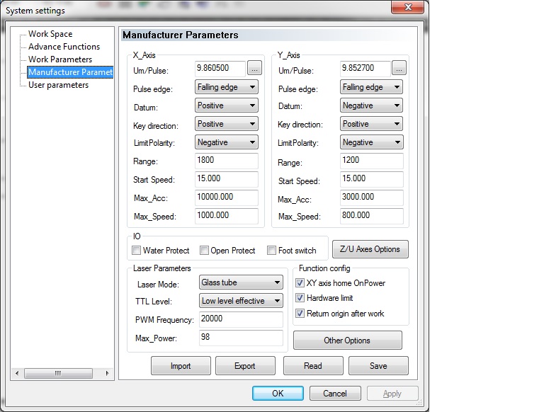

Well, I have just replaced the RDLC320-A DSP with the AWC608. I finally got all the motors going the correct directions homing to the upper right corner. Still having problems with the auto-focus feature. I also discovered that the DSP would not fire the laser. The only change in the system is controller. The water protect and open protect is connected to the PSU, not the DSP. I don't have water protect or open protect enabled in firmware. I don't know what I am missing here. I know the laser will still fire - just not by using the DSP.

zkmiller wrote:Laser fires now...water protect to the PSU was staying high. Fixed that but now can't seem to get the open protect to work. What input should the open protect be connected to? I tried IN1 but it had no effect.
You need to enable the "Open Protect" on LaserCad setting

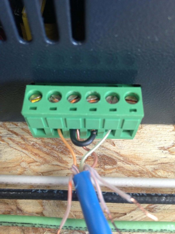

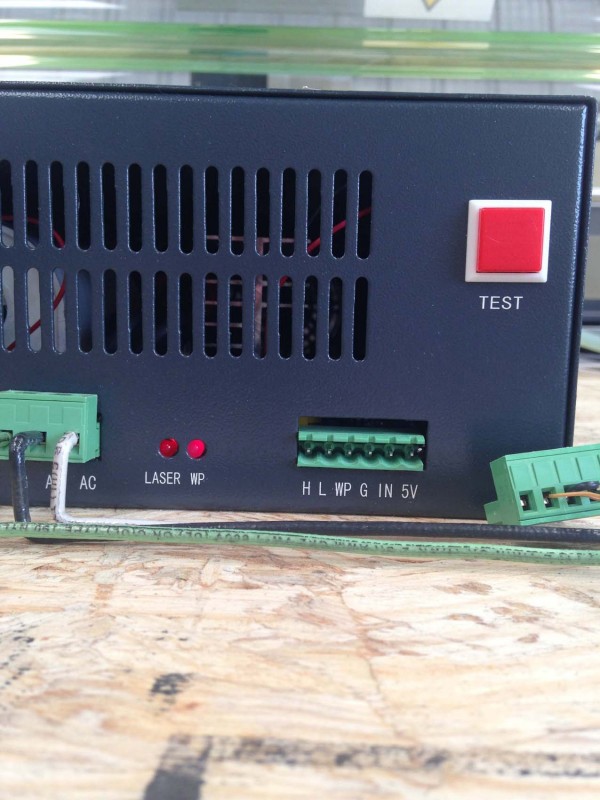

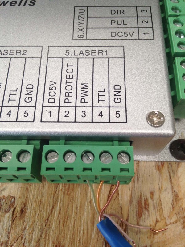

I'm not sure if you were talking to me or to Zeke about open protect Marco. I'm having the same problem, laser fires when I press the TEST button on the laser power supply but doesn't fire from the control panel. I've double checked my wiring. The laser current meter says 0.0 but every few seconds it says -0.0, then back to 0.0. When I press the LASER button on the control panel, nothing happens, laser doesn't fire and the meter doesn't change. I must have missed something but don't know what it might be.

You jumped into too quick when I was talking to Zkmiller. He was asking for something else: Open protect which was not the same case of yours. Then you jumped in and I tried to answer your question after him.
When I saw "Open protect", it was about the front door open protection, not water protection. Open Protect is controlled by IN1
Bob, you didn't get fire because you didn't have "Water protection" connected. You need to make sure that the power supply has a water sensor installed to "WP" & "Gnd" that enable the power supply to fire once water is flowing.
To do test, you can by pass it by putting a cable two bridge the Gnd & Gnd

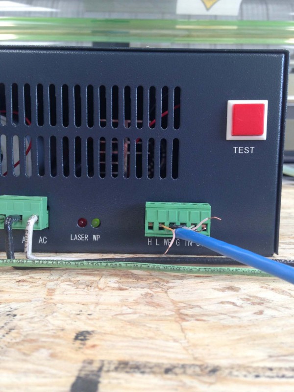

Sorry about that Marco, didn't mean to interrupt. Ok, so I've ordered the water sensor and will hook it up as soon as it comes. But you say I can at least test it by putting a cable to bridge the Gnd and WP on the power supply. I'll give that a try.

Yep, that worked. I won't do any more firing until that sensor comes. Thanks Marco, I really appreciate your expertise.
