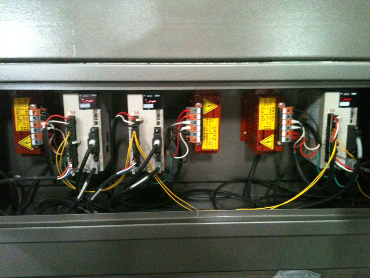

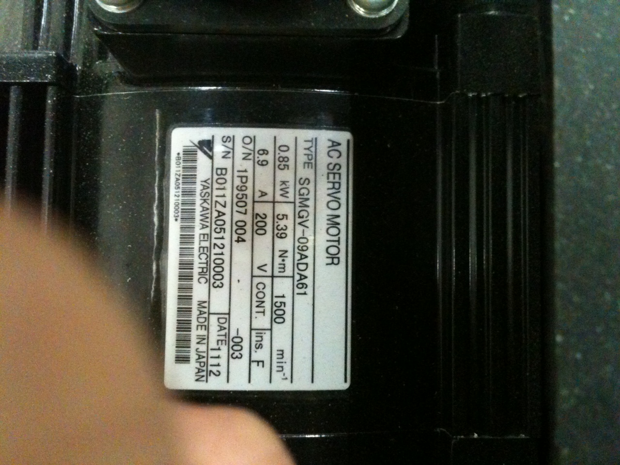

I'm running lead screw with linear bearings powered by a Yaskawa 850 watt high inertia servo specifically matched for the load calculated by Yaskawa engineers to give me excellent positional accuracy up to 700mm/sec before having sync issues due to load.

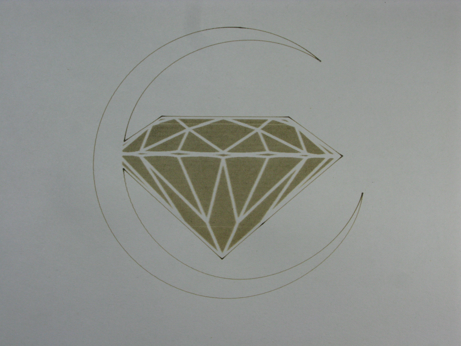

Re: Engraving and Cutting not lining up. Help Please!
Here is what I got. I compared the worked and the image file, I didn't see any difference. Please point me to the location where the 2mm "shift" movement happened.

Thank you for testing that out for me. My pulse unit is set to 10 pulses per unit (um). I originally had it set for 1 pulse per unit (um) and when the Yaskawa engineer came to assist with tuning, he told us that the pulses were "not pretty" and that could cause problems after hooking up his computer to the drive as the dsp was driving the axis. We then set it for 10 and he old me it was acceptable. Could you ask the engineer what else I can do to make this work?
If you have been following my postings with Charlie, it seems that you guys have pretty much the same equipment yet your machine doesn't have any problems but his is exhibiting the same problem as mine and he isn't running servos. My question is, is it possible we both have the same machine setting problem and yours is set correctly.

After magnifying the picture you posted, I noticed that your engraving also exhibits a slight shift to the left. If you look closely at the top to corners of the diamond and compare the two sides, you will note that the engraved part is not exactly centered as it is in the original file. I think mine is just more pronounced.
In problem solving mode, I think there must be some logical cause as both Charlie and I both have this problem yet our machines are completely different so I feel hopeful that we can solve this problem.

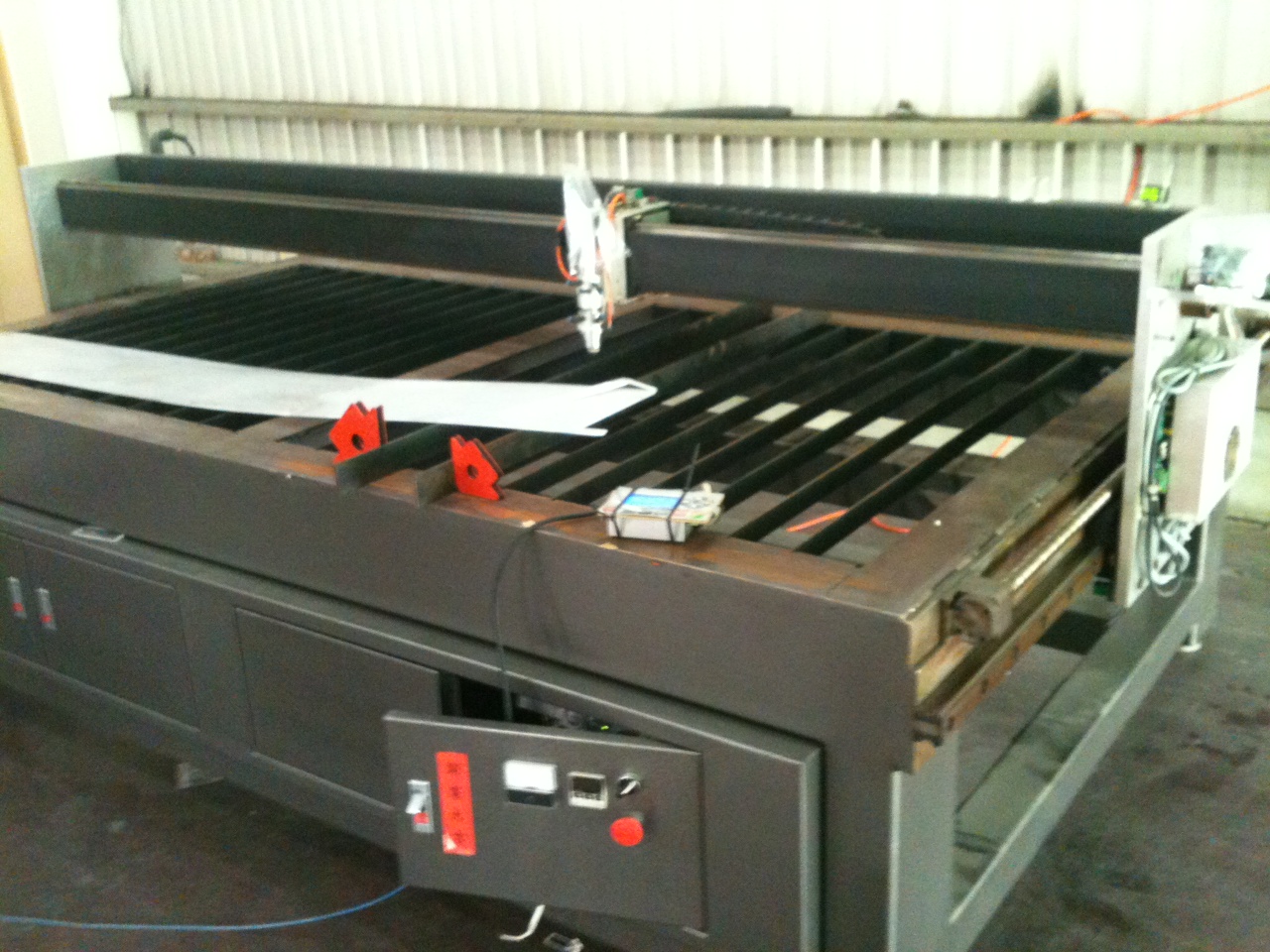

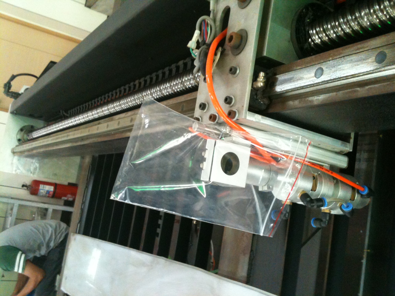

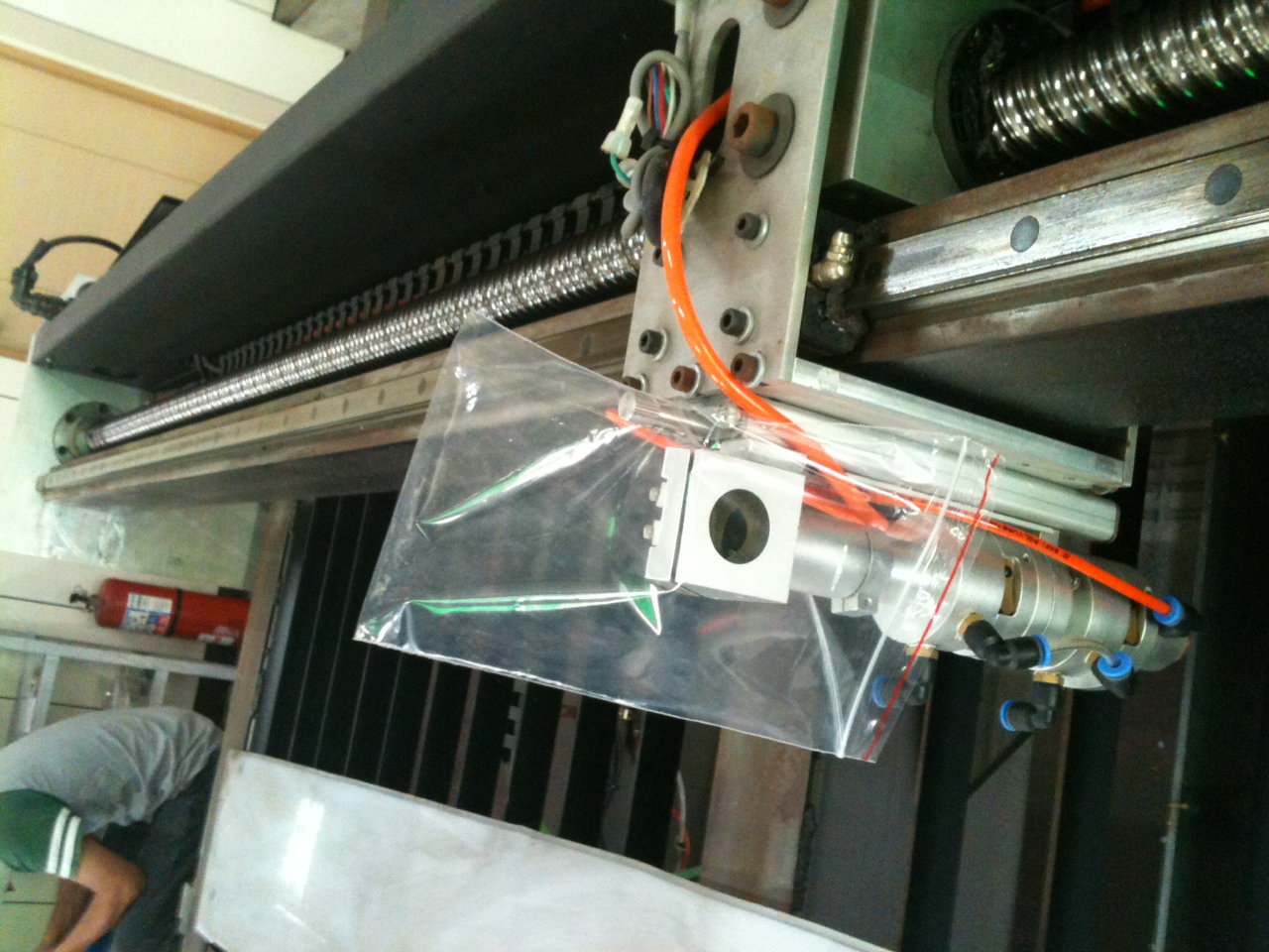

Thank you so much for following up with me. I have included some pictures of my machine build for reference.
David

chakata
Posts: 33
Joined: Sun May 06, 2012 12:16 am
Post by chakata »

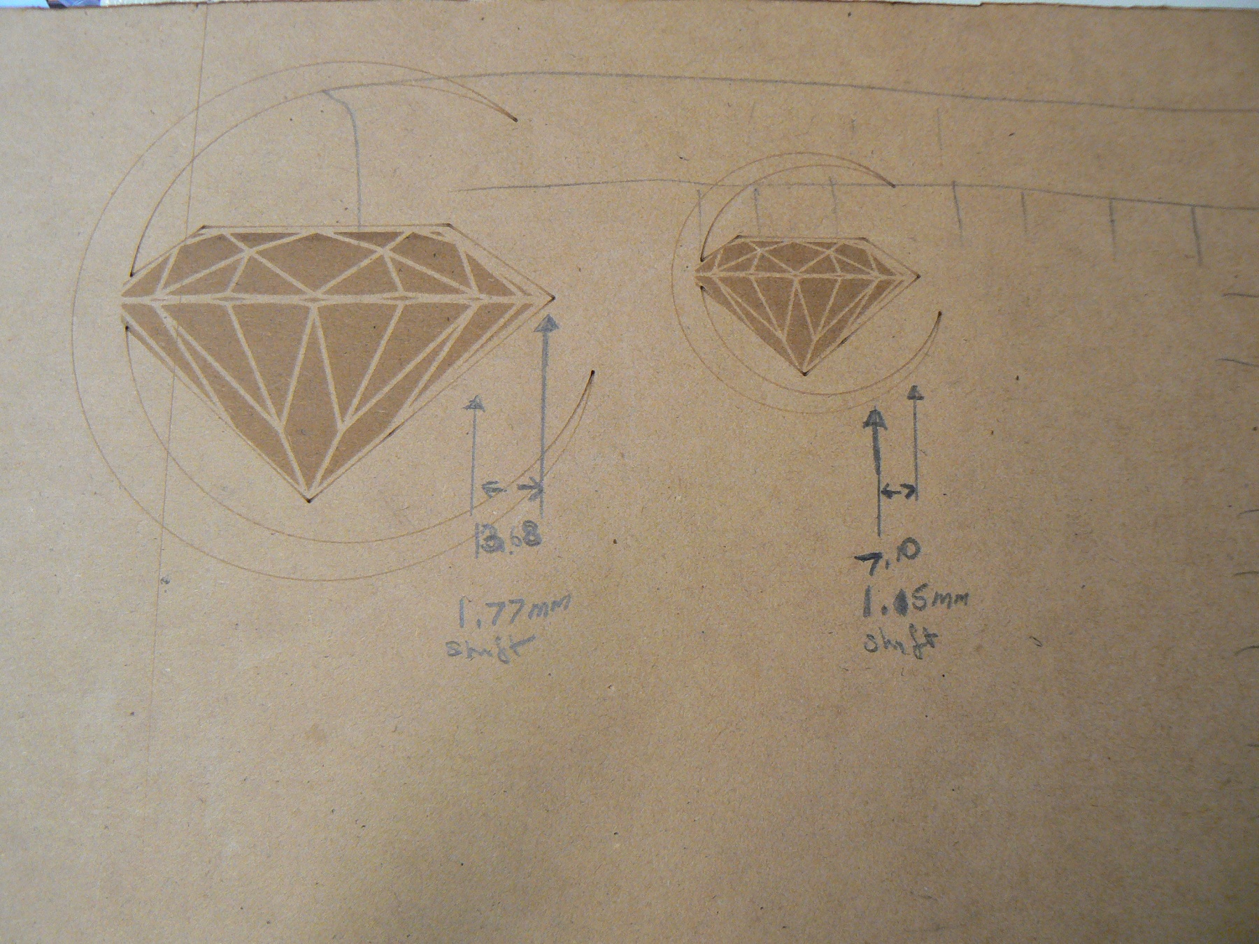

Hi David , I thought I'd run your file again and this time I added a scaled version (half x dimension) on the work area ,side by side. On my attached pic you'll see that both the large and smaller diamond shifted to the left , probably proportionally. {Interestingly that your small scale diamond appeared shifted to the right} I,ve taken some measurements and allowing of course for a few degrees of measurement error I,ve concluded that large diamond shifted 1.77 mm and the smaller shifted 1.15 mm. My points of reference are the apex cut box surrounding the diamond (right) and the apex of the first shape to its left , both having same y co-ords.
Charlie
