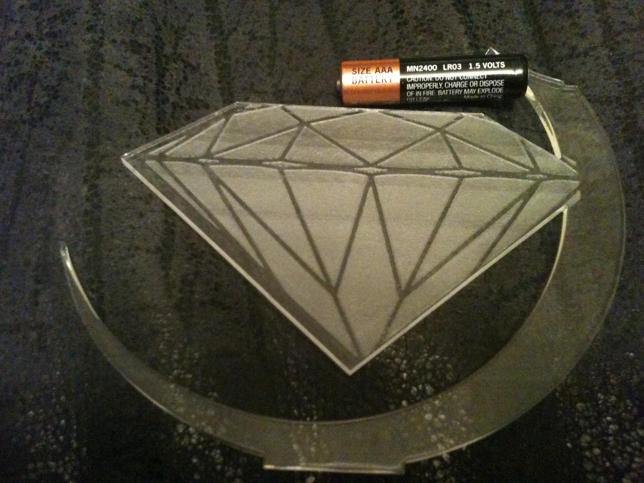

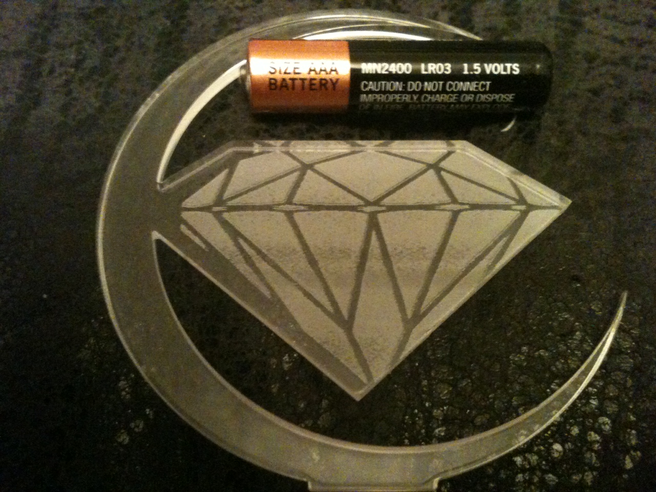

Hi All,
I've been having a lot of fun with the AWC608 DSP and finally had some time to really get down to doing some engraving work and ran into a problem I'd like to see if someone out there could help me with.
Here is a brief summary of the problem:
When I send a file to Lasercad 5.93 (scared to upgrade after hearing about some "insane accelleration" issues so I'll wait a bit to see if 6.27 solved that mystery) everything looks fine. Then, I noticed something strange happening. The engraved image did not line up with the cut image??? In Lasercad everything looks fine and the engraved diamond is sitting perfectly in the center of the outline, but when the cutting began, I noticed that the engraved image was shifted to one side by a few mm.
I have included some pictures of the sample with one large and one small. Regardless the size, I get the same problem. I've included a AAA size battery for scale. I've gone through the manual and searched the forum but came up dry looking for a similar problem so maybe I've overlooked something in a setting somewhere. I'm using x-swing unilateralism until I figure out how compensate for the return scan not lining up. Maybe it is related to my current problem.
Thank you in advance for any help or assistance you are able to render,
David

Re: Engraving and Cutting not lining up. Help Please!
Can't tell which one is cutting and which one is for engraving. It's better yo include the project file and let me try it here
Also, did you upgrade the OS? If you just upgrade LaserCad from v5.93 to v.6.27, there is some issue. You need to upgrade the OS as well
