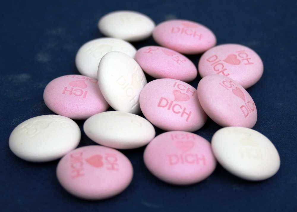

you are right. I don´t use the traditional MandM-Candys because they are not so large and i can not engrave so much text or massages on it. My board, where the Candys fit in are not only holes. the hole is getting smaler, when it is getting deeper, so I can engrave a lot different candys with different diameters.
I tried your file, but I have only CorelX3 running here. could you please save it as a corelX3-file-format, so I can try yours?
I have a laser with 50 Watt and I engrave the candys normaly with following settings:
Power1: 60 %
Power2: 65%
Speed: it depends on the deepnes I want: between 20 and 25 m/minute.
Attached you can find a foto of engraved Candys, but you don´t see it so good on a picture as in real.
