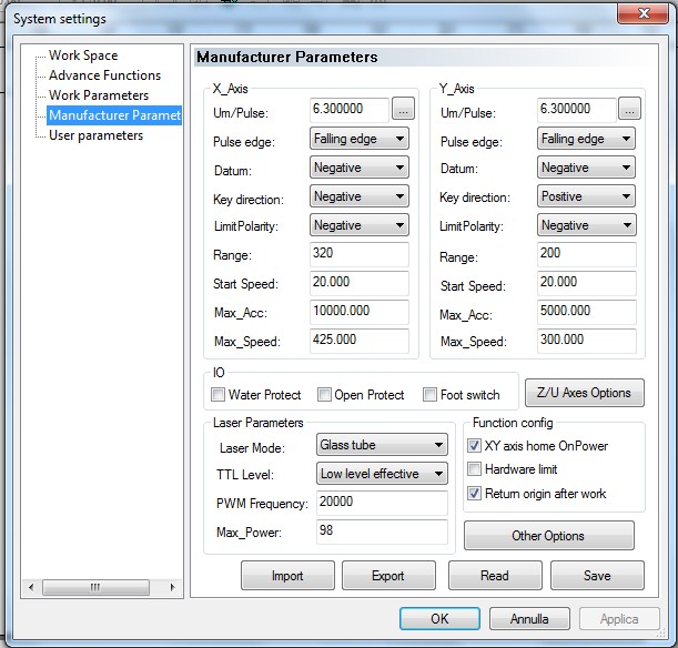

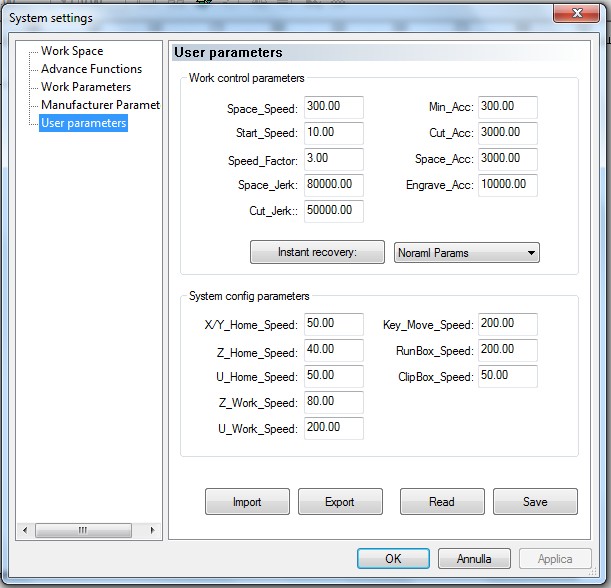

Hi Marco
these are my settings in lasercad, tell me if they are good,
the power supply is that of your DSP kit, lenses and mirrors are clean,
but mirror are slightly scratched and the lens of fire is clean but a bit opaque, hazy, perhaps the fault is.
These parties are held with k40 and so do not think are very good. The mirrors are aligned.
Soon I will have to buy new mirrors and lens, before making the order I will contact you first.
Alfonso
Alfonso

- Posts: 4654
Re: a simple question
The kit doesn't include a laser power supply. Are you using the original from K40?
If the lens is dirty, it will affect the performance a lot
