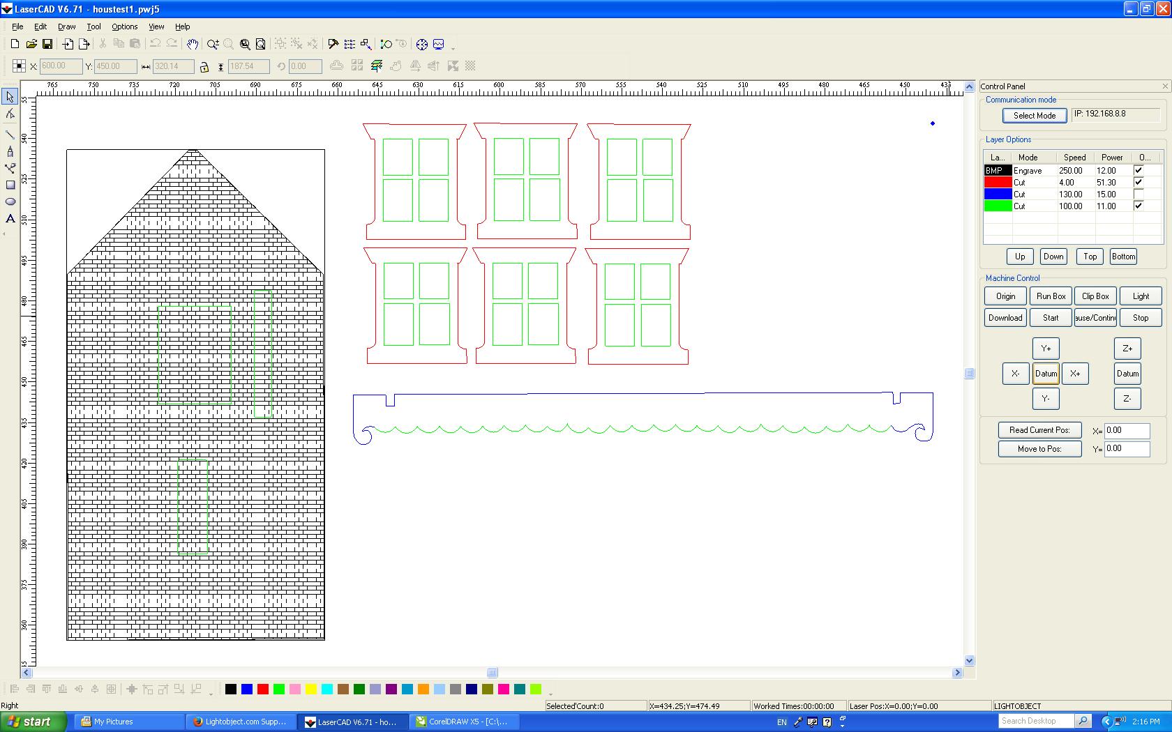

now I got a problem or maybe probably is that if I insert a pattern in a object lets say the roof tile pattern in a house roof in CorelDraw x5 and send it then to lasercad the pattern shows up as square not in the form the roof is.
maybe marco can ask the programmer why tis is and how to fix it.
pattern inserted in a object in corel comes out as square in

attached are the two files one is the original CorelDraw X5 file and the other is the lasercad file

You need to convert the patten square to "bitmap" and it will show exact on LaserCad. Currently it is a layout but not an object
But it is not perfect yet as the outline border still seem. Well, I think it is all about the layer issue on CorelDraw. Since I'm not an expert and I know a little. I let you to figure it out

thanks for your afford but the problem with the conversion to bitmap is that the laser then will engrave it and not cut it like the vector and takes a long time. and it also uses the square border to engrave
there is only one layer in corel.
