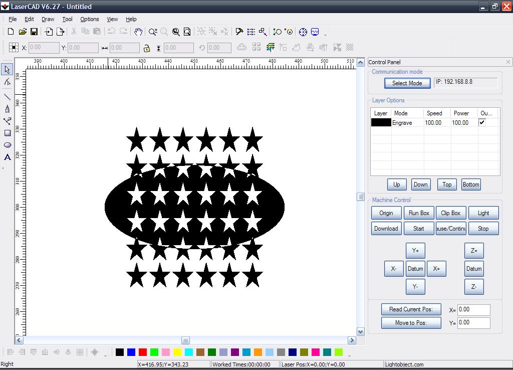

I've spent hours trying to figure this out and no matter what I try, I get the same results.
Here's what I'm trying to achieve.....

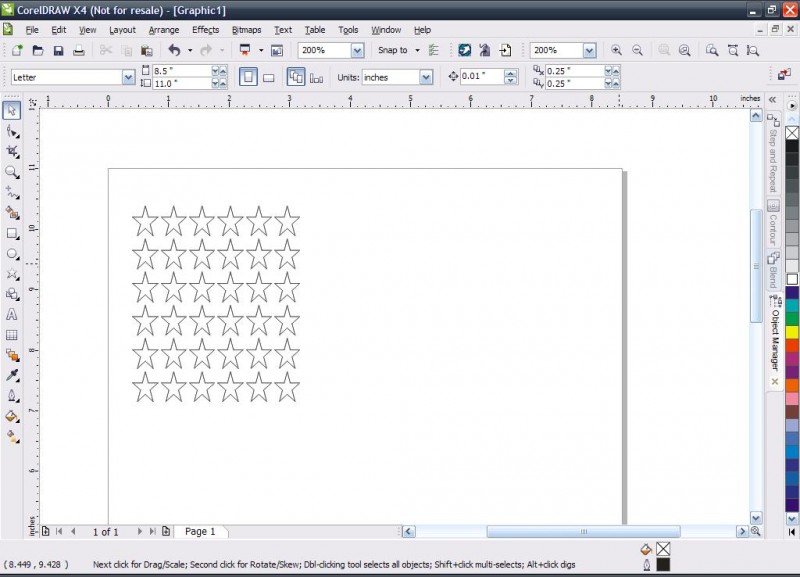

- Make a fill pattern, (in this example, stars)

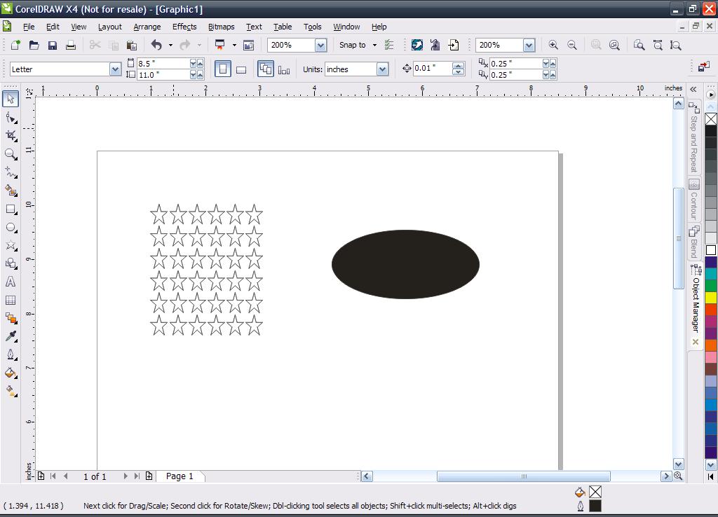

- Make a shape, (in this example, an oval)

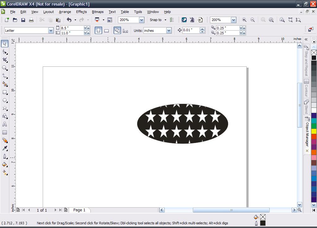

- Fill the shape with the stars
- Send it to LaserCad to engrave it the way it looks in CorelDRAW X4
But as you can see, every time I send it to LaserCAD ALL the pattern (stars in black) shows up, which is of course unusable. It needs to look in LaserCAD the way it looks in CorelDRAW !

Re: Corel Powerclip and LaserCAD problem
I was using "Front minus back" or "Back minus front" where star and the ellipse are belonging in two layers
THANK YOU Marco !!!
I made the oval "back", the stars "front" and then clicked "back minus front" and that did it.
I was trying to over complicate it I guess.
