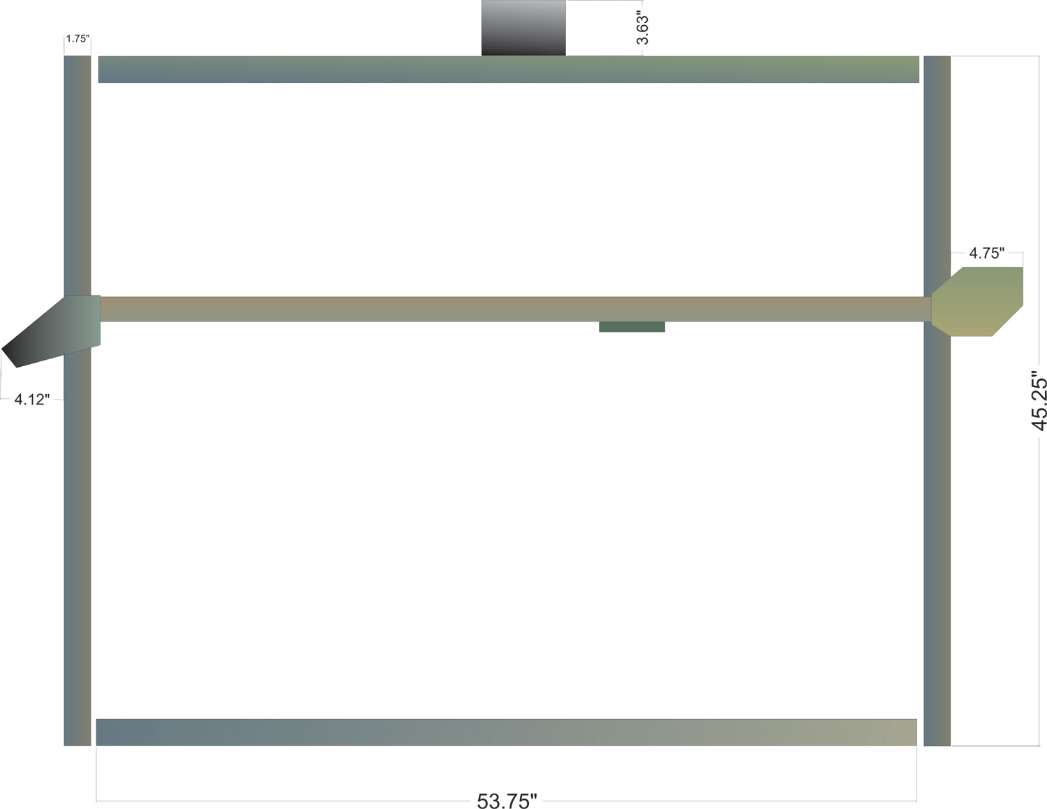

Anybody have the 900x600 XLE stage, who would like to post the inside dimensions of the XLE900x600 stage? From profile to profile, both width and height.

Sorry for the late reply. I have done a preliminary measurement and the precision should be less than +/- 2mm
Posted two files: Jpeg and Coreldraw X5
- XLE90120.cdr
- CorelDraw X5 file
- (398.66 KiB) Downloaded 272 times

Thanks Marco
This must be the 1200x900 table.
What I can deduct from this is that the x is nominel + 165 mm and Y is nominel + 160 mm, so the 900x600 table must be around 1065x760 inside dimensions.

Oh...sorry I think I mixed up the diagram. You're right, it is the 1200X900 model.
And yes, you can simply minus 300 on X and 300 on Y should get you closed to the 900x600 stage. I'll try to get the 'blue print' from my manufacturer and once I have it, I'll post it here
