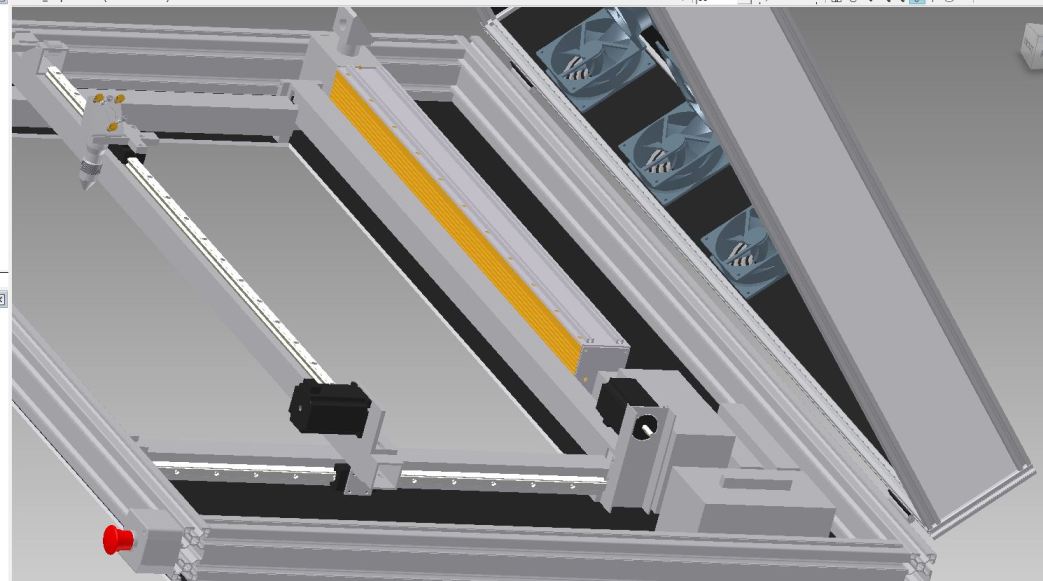

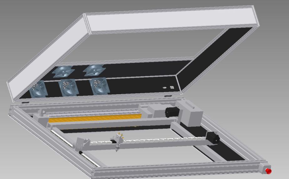

We have started to build a flat table lasermachine, and therefore we are using the AWC608 controller
Our rf lasertube is a Synrad J48-2S-SGC and this one will be dismantled from a laserpro machine togehter with the powersupply and aircoolers.
See picture of how our model will look like.
The controller will be a separate box.

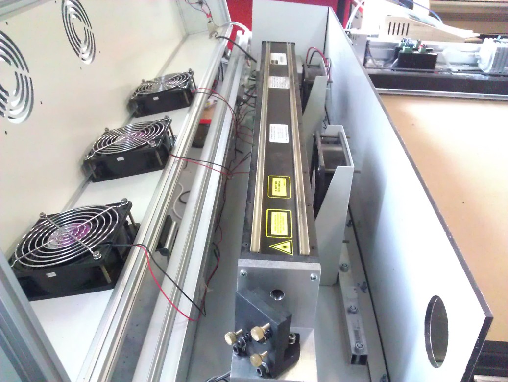

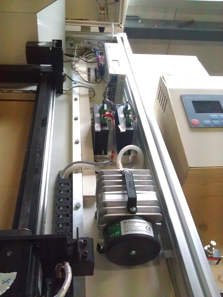

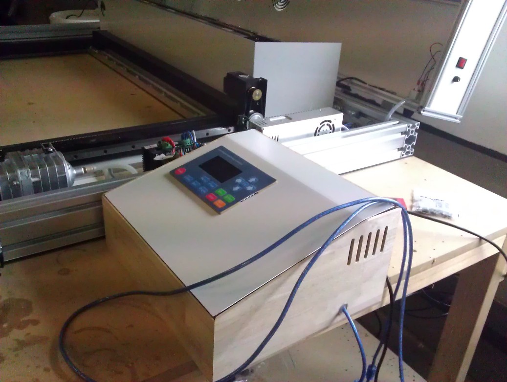

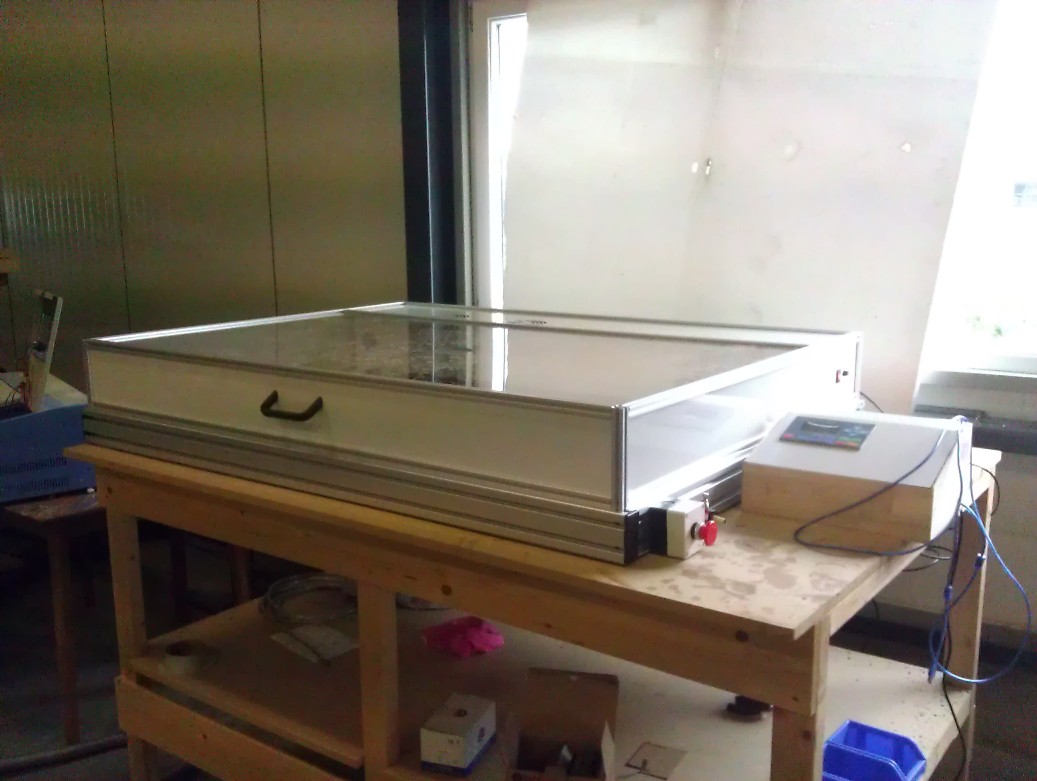

Re: Synrad RF laser, new flat table laser model.
Hello All,
As promised some pictures of the flat table laser machine.
Last week i build the machine and today i have build the controlboard of the machine.
THe laser is firing and the machine does run, next monday i will install latest patch and software parameters.
Also will install the mirrors and lens.
Herewith some pictures.
If you would like to know more about this project, pls shooot.
Kind regards,
Ruud Hogenberg
gippetto.com
