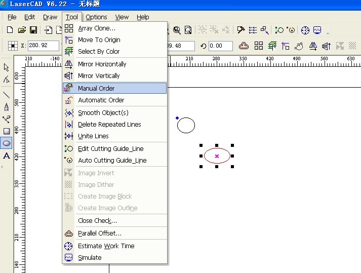

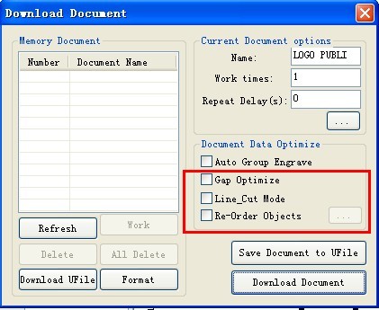

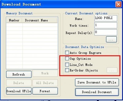

I talked to Li (programmer) and said that the start point is controllable. Make sure that all three option are NOT "checked" See attached images.
After clicking "Manual order", all art work will show a start point (in red dot) . By moving around the Red Dot , you're changing the starting point as wish. At the same the time, there is a arrow indicating the direction of the route. By the way, before sending the job to laser for a real work, you can do simulation using "Simulate" feature under the Tool menu.
Note: you can change the speed of the simulation by holding "Shift" & "-" or "Shift" & "+" It's a cool feature!
