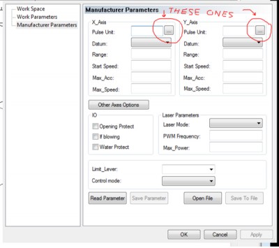

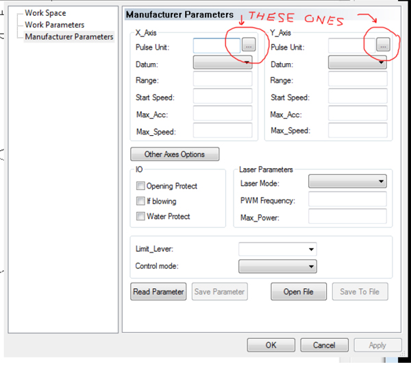

Re: RF Laesr Pin Setup and Focus Lens
This is where the pulses test button is. (page 26 in the manual) Picture attached.
I think the High low setting for the limit switch setting actually changes the way the whole program works and I reckon it is how you change the high low for the laser as well. I seem to recall that I changed it a few times and had to alter other settings to compensate for the change. I may be wrong but I'm 80% sure.
The manual needs a serious update to keep up with the software engineers changes. Most things are just covered enough to get you in trouble and they need to invest a lot more time in it to make it more legible for the layman and maybe even explain what the different thing do. They are 90% there but not all the way yet.
