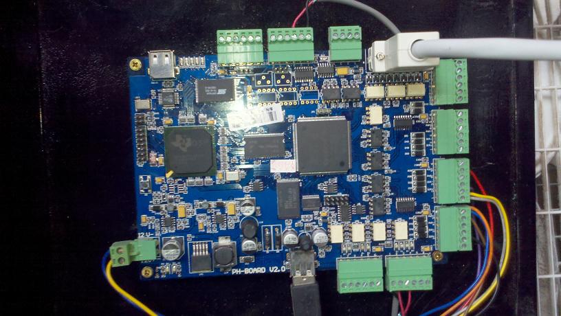

Marco. I have attached the picture of the DSP board. I double checked the voltage between pins 1 and 4 and it is at a constant of 4.5 or so volts.

Posts: 4654
Re: RF Laesr Pin Setup and Focus Lens
Chris, can you take a close up photo for that bar code. They need that to check the version of your card

Sure no problem Marco.. I'll send it over tomorrow. I also noticed that I am not getting any modulation off of pins #1 and #3. It is basically just on and off with full power, from what I can tell. I tried what I thought were all of the correct settings in the software, but none of the changes seem to effect the beam power.
