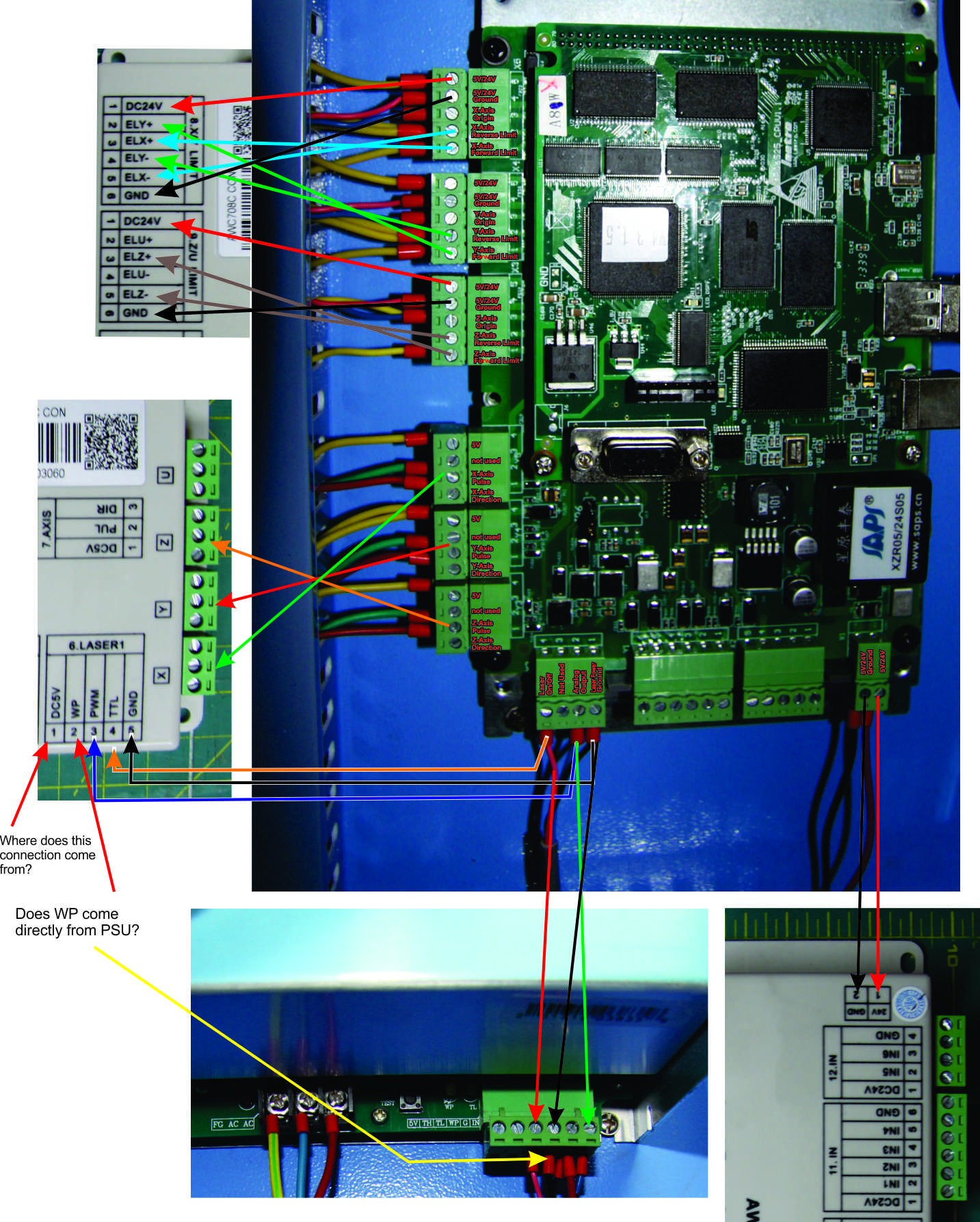

Kees or Marco - No power to panel or controller. Checked with multimeter - no power to controller - which comes directly from converter? Please see attached picture of conversion. Note on the x7 laser1 pin array I do NOT have a connection for the 5V or WP. Does this connection come directly from the PSU (not sure that is what it is called - a picture of its pin array is also included in the single pic.
- Posts: 492
Re: Nadda... No power, no bells, no whistles
Ok,
The +5V at the laser1-connector is an output from the controller. Some laserpowersupplies need that to supply the logic (think of the optocouplers inside..) It can be you don't need that. Same as the WP (Waterprotect) In some cases the Waterflowsensor is directly connected to the HV-laserpowersupply. That is safe enough, but your controller doesn't notice anything of a problem with the waterflow and shall continue to work.. (for that reason I connected the Waterflowsensor to the controller instead of the HVsupply)
Then your +24V supply.. If you don't measure 24V volts on the small 2-pole powerconnector of your controller, check the 24V comming from your switched-powersupply. If you don't measure 24V there and the mains is on, then your powersupply needs to be changed. If you do measure 24V there, your wiring of contacts are defective..
The other +24V connectors on the controller are outputs to supply the limitsensors (proximity-sensors can work fine with 24V)
One thing i see is probably a "Open-cabinet-switch" (somewhere at the bottom) can it be all power is taken off when you open the cabinet? (so you have to fool that switch or bypass it?)
- Posts: 91
- Joined: Thu May 21, 2015 9:44 am
We have light - power! Some buttons working some not - will report back shortly.
I can only believe that it was the door switch - although I taped the door switch during power up, it may have been insufficient. When I read your comment on the door switch, I reinstalled the door...and voila - there was light.
