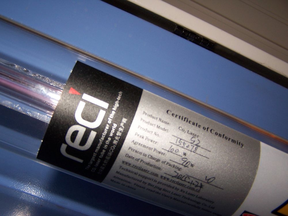

Is the laser tube "S" series? Check the manufacturer date. If it is some where less than 9 months old but older than 2 month, chance is that the tube is defective. It is because Reci got production problem since a year ago when they launched the "S" series

yes, there is a burn mark..I also just noticed that its now reading 24ma ,which just earlier it was 28ma.. heres the tube..
