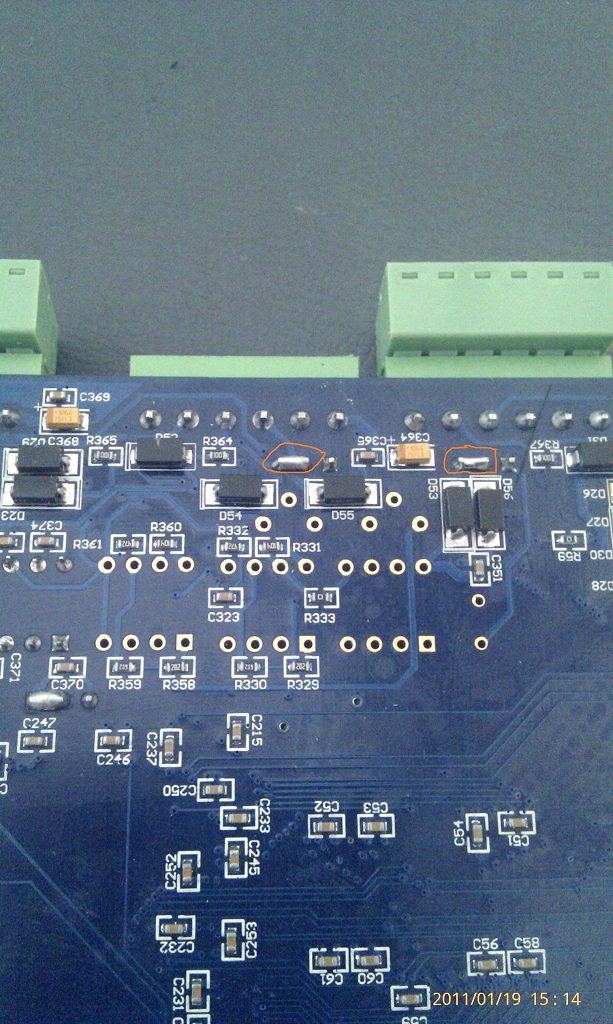

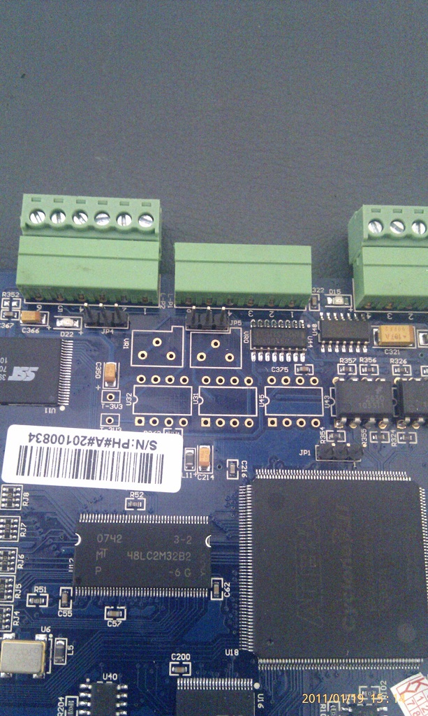

JP4 & JP5 have the middle pin bridged to the right pin with solder! This is because the other pin is routed to components which are missing! My feeling is that these components were the digital to analog converter or similar - why are they no longer there??
Have a look at a board you have in stock and you'll see what I mean

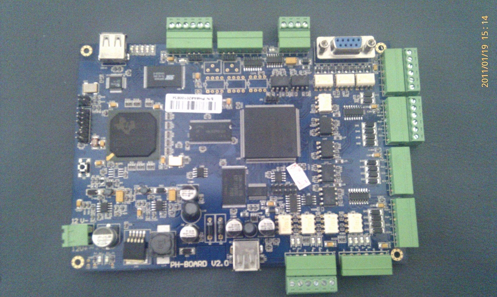

I've attached some pictures for you:
1. shows the full board
2.Top of the board where the jumpers are. It clearly shows the missing components
3.Bottom of the board where the jumpers are. I've marked where the solder bridge is on both of them
Do you have any further ideas?
