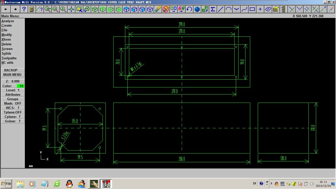

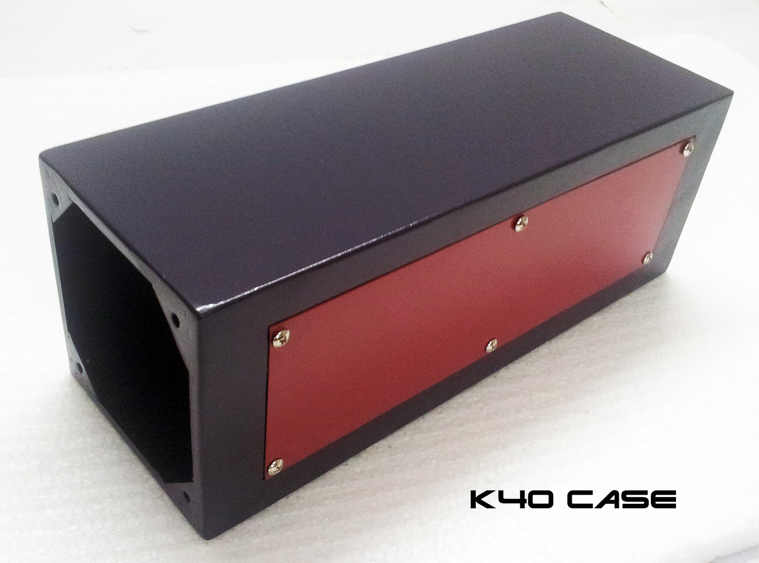

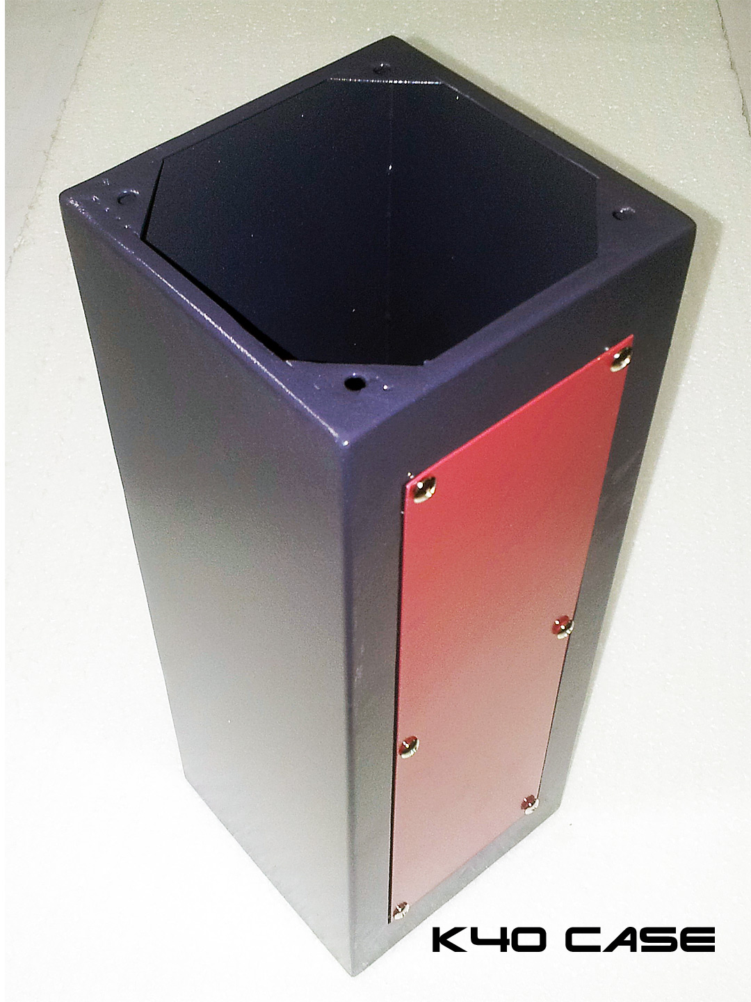

The prototype is completed. I'll get more info like dimension and weight soon

I would strongly advise adding a triangular gusset plate along one side that would then attach to the side of the K40 chassis. The amount of the extension you have there with only four screws inside the extension will create a lot of torque on the extension if it gets bumped. It sticks out far enough that I'd want to add protection. A triangular gusset would help prevent damaging an expensive laser tube.
- Posts: 4649
Re: Larger tube for D40 or K40 (1000mm tube upgrade)
It is not necessary. The cage isn't very heavy and four M4 screw is strong enough to hold it there. Even a big machine with bigger tube are sharing similar design on extension case.

I have one of the first batch of the cabinet extension. Generally, looks great! But have noticed one detail that could catch some unaware -- it looks like the mounting holes were hand-drilled without a template as they aren't even close to being square with each other. One of them is off by a 3-4mm (which is how I noticed this). This certainly doesn't adversely affect using the case, but it does mean you can't drill the mounting holes based upon a drawing or spec and have any hope of the actual holes aligning. The easiest approach is going to be to make a drilling template directly off the actual extension cage, then drill the case based upon that.
