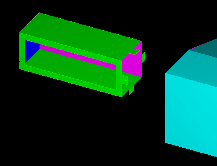

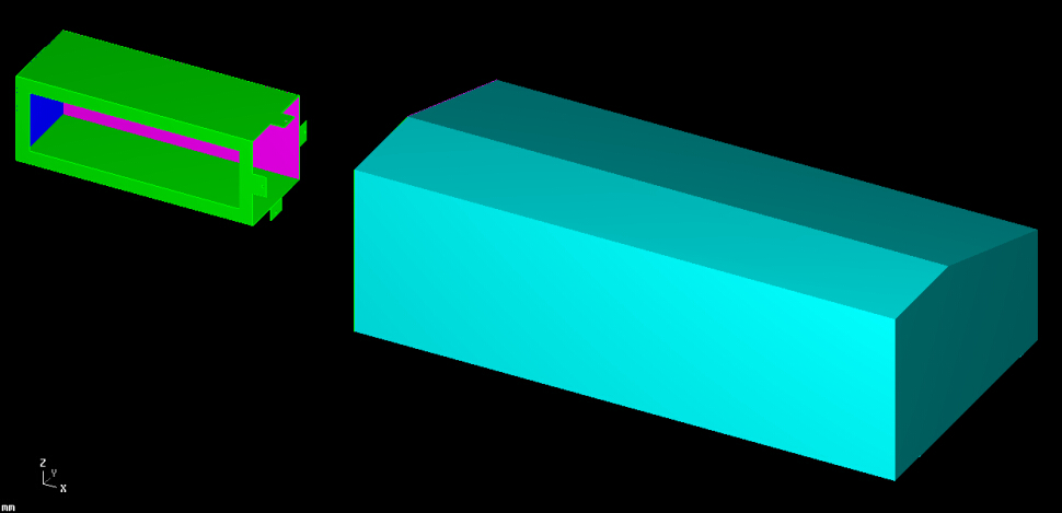

Update:
Drawing is complete and price quote received
$42~$48
It is roughly 300mm long, the max length to fit a 1000mm (45W) tube into it. Customers need to make a hole on their K40 machine and that is the most difficult part need to do
The extension case will be painted in Blue color
Sample should be available in 20 days
