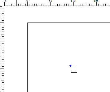

I've tried to figure out what this one is doing, it doesn't make much sense. My test file in LaserCAD is simple: I draw a 10mm x 10mm box whose upper left corner is at (100,100) relative to the canvas. When I run this job, the box isn't anywhere near where I expect it to be. I expect the box to be cut 100,100 from somewhere.
Key: You move the laser head to whatever point you want to be the Origin, then press the button "Origin" and the machine pick that spot as origin even though after Reset is press
This is the most useful one to me. My DSP is set to "Key".
I expect pressing "Origin" on the DSP to set the point that corresponds to (0,0) on the drawing surface in LaserCAD.
I believe the issue is related to the little blue diamond that LaserCAD shows - This appears to be the software origin, and it is calculated to be the upper-left-most part of the figure to be cut. I would like to know how I can make that blue diamond always be at (0,0). Today I do this by adding a Pen Run around my figure.
Hopefully this will illustrate: When I create a new figure and put in my box, here is what I see in LaserCAD:
10mm square at (100,100)
The blue diamond seems to be the figure's origin. I will call this the "origin dot."
If I add another figure, the "origin dot" moves along with it.

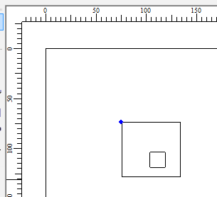

new rectangle, new origin dot
What I want is for the origin dot to be at (0,0).
When I do a project, I am sometimes lasering onto an existing workpiece that has its datum in the upper left corner. The figures to be lasered are NOT at this location, but the workpiece is. So, if I want to laser a hole at some exact coordinates on my workpiece, I would like one corner to be the datum. The workflow would be:
- Draw the holes onto LaserCAD where I want them to be relative to (0,0). (for example, by importing a DXF from a CAD model).
- Install workpiece onto the laser, jog to the corner and press ORIGIN. Now the origin corresponds to the (0,0) on LaserCAD, which corresponds to the datum in the CAD model.
- Run the job.
Current software will assume that the left/top most piece of whatever is being lasered is the origin.
Unless of course there's some way to move that blue diamond to (0,0). Today I can easily do this by just putting some figure at that location, like a pen run.
I hope this makes sense, it's not easy to explain.
