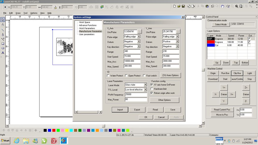

I save the parameter file my self with the name manufsetLC here is mine
to set this : go to tools - manufacturer settings - read - then put my settings in - then save and export to your harddrive

Thanks Walt for your effort. I found a better way to do it.
"File" -> "Export Config" and it will save all configration info of the main-board in one file (Manufacturer parameters & User parameters)

You need to configure the card first befofe you export it. Use the "Import Config" to read the file under "File" from the LaserCad
