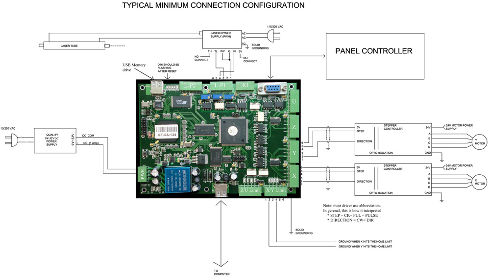

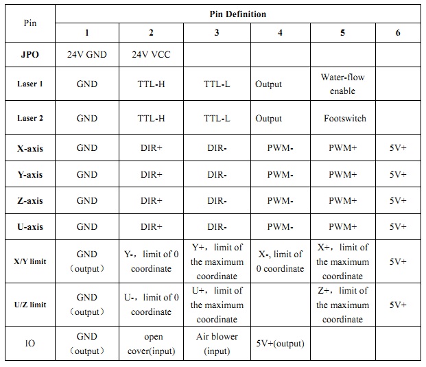

I have received my LO DSP. It was delivered very quickly. Direct from China. Thank you Marco
You can imagine my surprise to discover that all the info I have been able to track down re driver connection has shown to be incorrect.
A couple of posts above the engineer even confirmed that "step/direction/ground" driver connection was available and OK.
See attached pics from available documentation. All show six connectors per motor. This is all from the documentation that is presently on the LO site.
Now I discover the AWC608 DSP has only three connections per motor. "DIR/PUL/DC5V"
I really feel I did my due diligence as to the DSP suiting my needs in this respect.
However I need to come up with a way around this stuff up.
It may well be that the engineer meant that I could source a ground connection elsewhere on the board, but I don't have direct access to ask that question.
Marco can you ask Programmer Li if this is what he meant in the above quoted post ?
Greolt

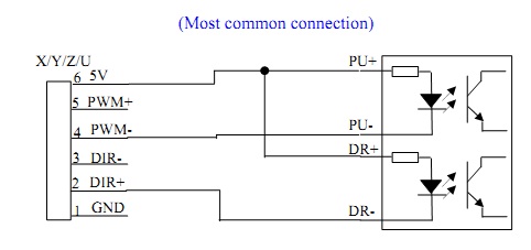

Re: Connecting controller to Gecko G251
That's an old connection diagram for V2 model!
I posted a connection diagram in many place and here is one you can look at
viewtopic.php?f=55&t=896
I didn't remove the old connection diagram just in case other folks who may need it
Regarding the ground, you can pick any ground on the connector. That's what he meant to

- Posts: 183
Thanks for the reply Marco.
I had not read that new PDF. Thanks.
I will proceed with the installation and pick up a ground connection from elsewhere on the board.
Let you know how it goes.
Greolt
Greolt
