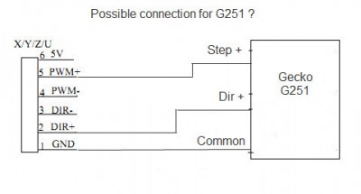

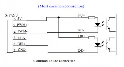

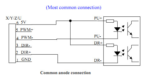

Every wiring diagram I can find for the controller has the drives connected to step, direction and 5v.
The Gecko G251s that I am using have , step, direction and common (Connect this to your logic (controller) ground)
Is the LO controller able to have this type of driver connection?

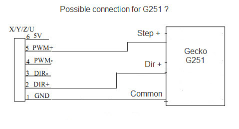

baccus61 wrote: I use Geckodrive's G201 drives in my set up and they work really well. Very easy to set up the motors
The G201s have step, direction and 5v. So this is the same as the connection diagrams in the DSP setup manual.
Unfortunately the G251s are different in that they have step, direction and common (ground).
I will be surprised if the DSP does not allow for this kind of driver connection. There is a common or ground pin at the DSP driver connection point.
However before making that decision I would like to hear from support. Will also give some indication of the future support or otherwise I can expect. ;)

Pic is from the DSP setup manual

I have 203V(common gnd) like 251- common to pin1, dir to pin 2, step
to pin4 instead of pin 5, when I hooked to pin 5 it runs ok but it keeps lost
step, but when i hooked to pin 4 everything ok, no lost step. my DSP is 2011 version not 2012.
when i use 201x step pin hooked to dsp pin 5 otherwise lost step. 201x common can be gnd or +5v

Support should be able to tell us whether or not the DSP can provide a signal with reference to it's own ground pin.
Doesn't matter what drive, Gecko or otherwise. This is a common way of handling step and direction signals.
