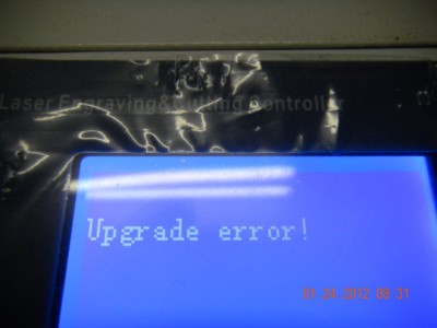

here are the picture from the upgrade process
thats the message
thats the message
I dont wana be the bad guy but there is something ether I miss or do something wrong
maybe somebody has a solution

I just dont know what is going on because I have try 5 different USB sticks three of them brand new bought them extrafor this and could not install the upgrade .
the LCD did show me the upgrade too but after I hit it the message upgrade error came up I have written this to you many times you allways put it on my computer this are new ones 2 of them and a XP .
maybe it has something to do with the download I dont know.
